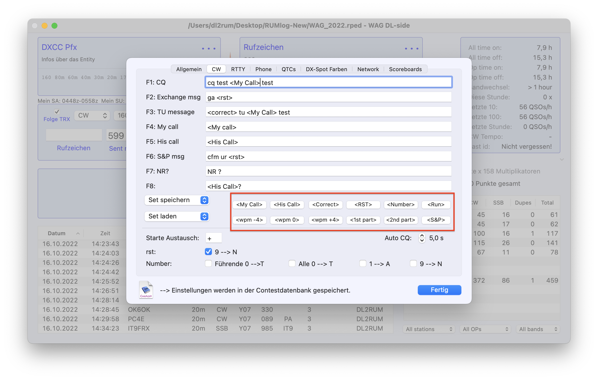

What I cannot find in the Help, which is at least poor, is the name to give to the various variables, e.g. in other logger, {MYCALL} or @MYCALL or similar.
Somebody can please answer? Maybe the author of the software?
73 Tilio iu3bro
Posts: 3137
Re: Contest set-up and use...
It's just in the CW settings:
