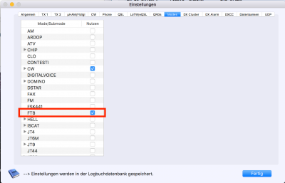

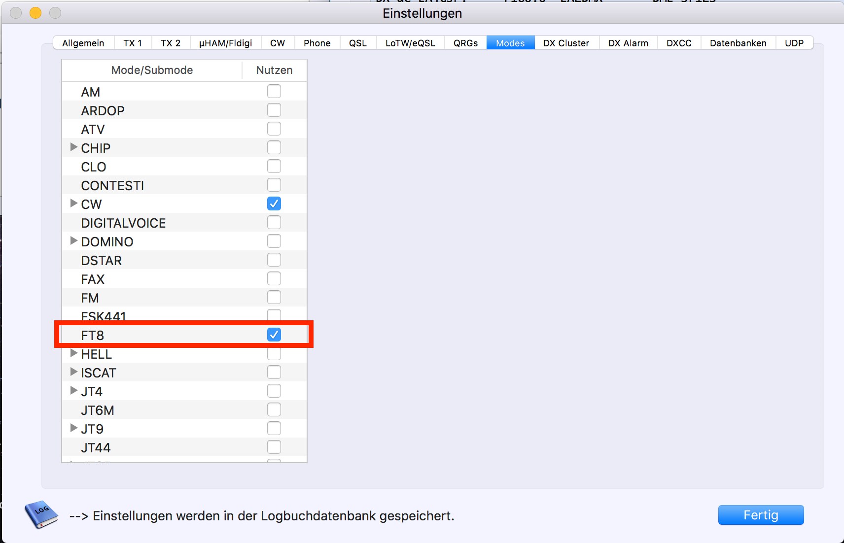

Would Mode be DATA and SubMode be FT8? Like:
DATA,FT8
BEcause just adding FT8 as an extra line in this file doesn't do anything.
Funny how this board doesn't have the ability to delete your own account. :shock:
Posts: 2959
Re: Cannot change mode to FT8
I've just added a new line with:
FT8
nothing else.
EA3HOE
Posts: 87
Joined: Sat 30. May 2015, 07:36
Unread post by EA3HOE »
That's the setting that i missed!!
Thanks Tom!

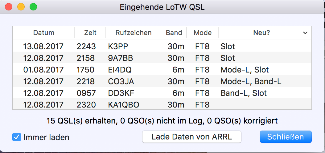

The ADIF specification v3.0.6 was approved by the ADIF committee yesterday.
The ARRL has today released v11.1 of config.xml, needed to update
TrustedQSL with the new mode.
So it's now possible to upload logs to LoTW with mode as FT8, no longer
mapped to DATA.
