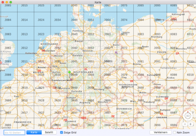

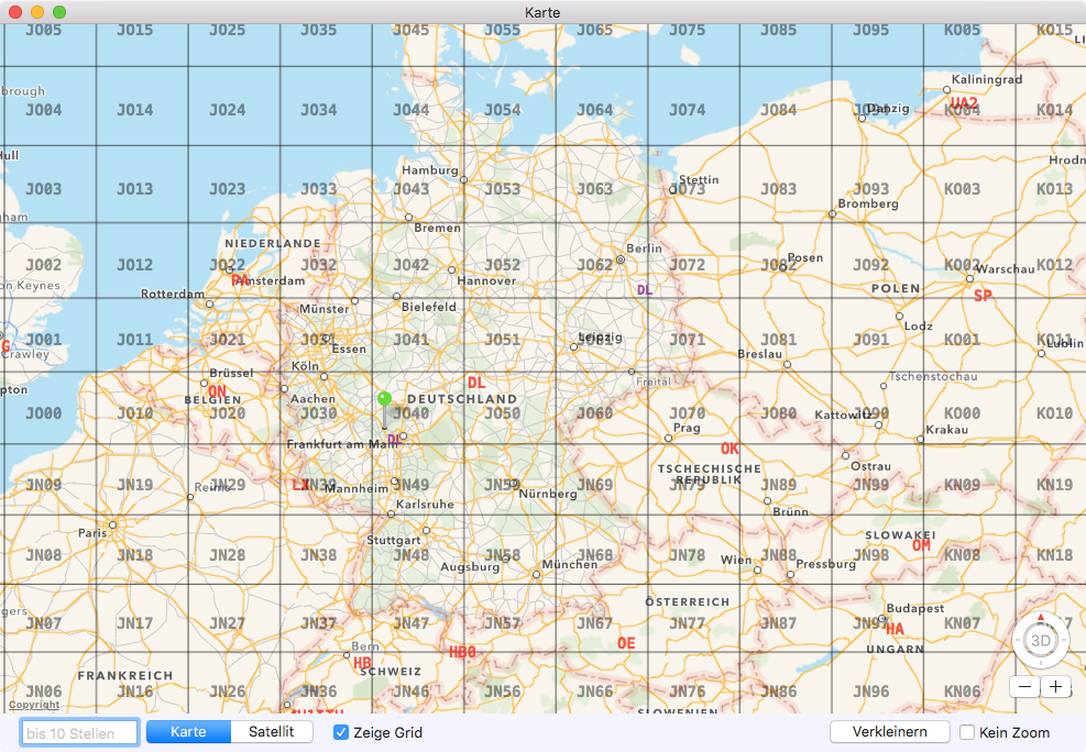

Add a grid square overlay to the maps

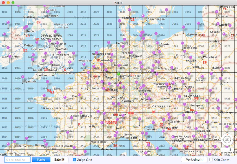

David, you can get it:
  • Go to Menu-->Window-->Search QSOs
  • Press the button Expert Search
  • Enter this to to get all worked grids:
      locator <> '' group by substr(locator,1,4)
  • Press the Search button
  • Mark all QSOs in the table (select the table and press cmd A)
  • Go to Menu-->QSO-->Show selected stations on map
To show all confirmed grids on 6m enter
band = '6m'  and (qsl = 'R' or qsl = 'X'  or qsl = 'G'  or lotwqsl = 'X') and locator <> '' group by substr(locator,1,4)
The needles show one station per grid, not the center
