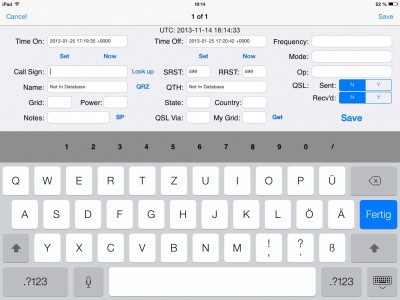

I attached picture of the keyboard that is implemented in the ham log and it is looking ok. For sure you can use still shift button, but with that keyboard it is more efficient and I would like still to use only iPad even if there is a lot of stations calling.
maybe there are other hams also waiting for that function...?
