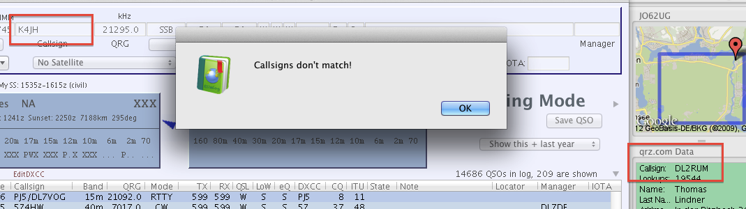

When I highlight a QSO and click HamQTH.COM lookup I get the popup window showing the lookup results, and another window pops up stating "Callsigns don't match!"
The same happens with qrz.com lookups.
I'm running 4.9 beta 3.
-jav k4jh

Well but that's the part I don't understand. For example, I have a QSO with YO8TTT, I do the search after highlighting that QSO and I get the error message, even though the call sign shown is the same?

Fire up RUMlog (I have 4.9 beta 3)
Highlight a QSO
Click on QSO -> HamQTH.com lookup
First the search result window pops up, then the error message pops up.
Not sure how to paste a screenshot, I'll email it to you.

That happens to me but only when I look up a portable call.
I don't use HAMqth I use QRZ.com but if I look up HH2/HB9AMO for example I will get that cautionary message.

qrz.com does not support portable calls. When you query for FS/DL2RUM, DL2RUM's info will be returned and most of these information may be wrong. HamQTH.com is working on it.
