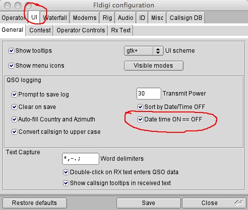

I am using the fldigi logbook update function, and I notice that the time pulled into RUMlog from the fldigi logbook is the start time of the QSO and not the end time. Would this be a possible issue? Generally when I have logged QSO in the past, either manually or from cocoaModem, the end time is used as the time stamp. I was wondering if one could add a switch so one can choose which time stamp is used when importing logs.
This probably a none-issue anyway ... thoughts? :-)
73 de André, M0JEK
M0JEK
Posts: 48
Joined: Fri 7. Aug 2009, 19:50
Location: St. Albans, UK
Re: fldigi logbook - time of QSO
Unread post by M0JEK »
Ah... silly me :oops:
I just found that it is a setting in FLDIGI UI configuration "Date time ON == OFF" needs to be checked to get what I needed.
