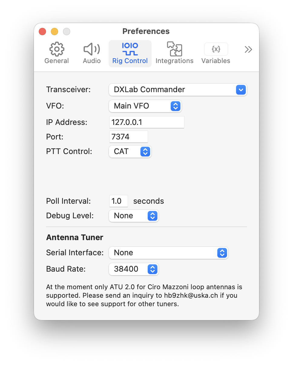

I appreciate that you have created a configuration app for the Microkeyer II. I am perfectly happy to accept that I have missed a critical setting. My goal is to simply use a Kenwood TS-2000 with the MicroKeyer II using its audio interface. I have already made the CAT control and Keyer work as they should.

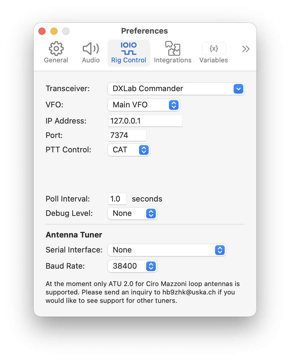

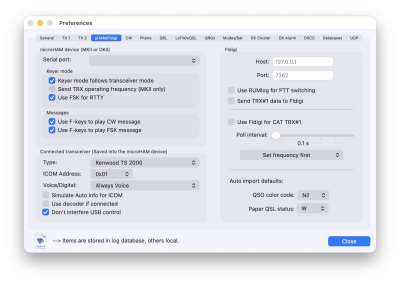

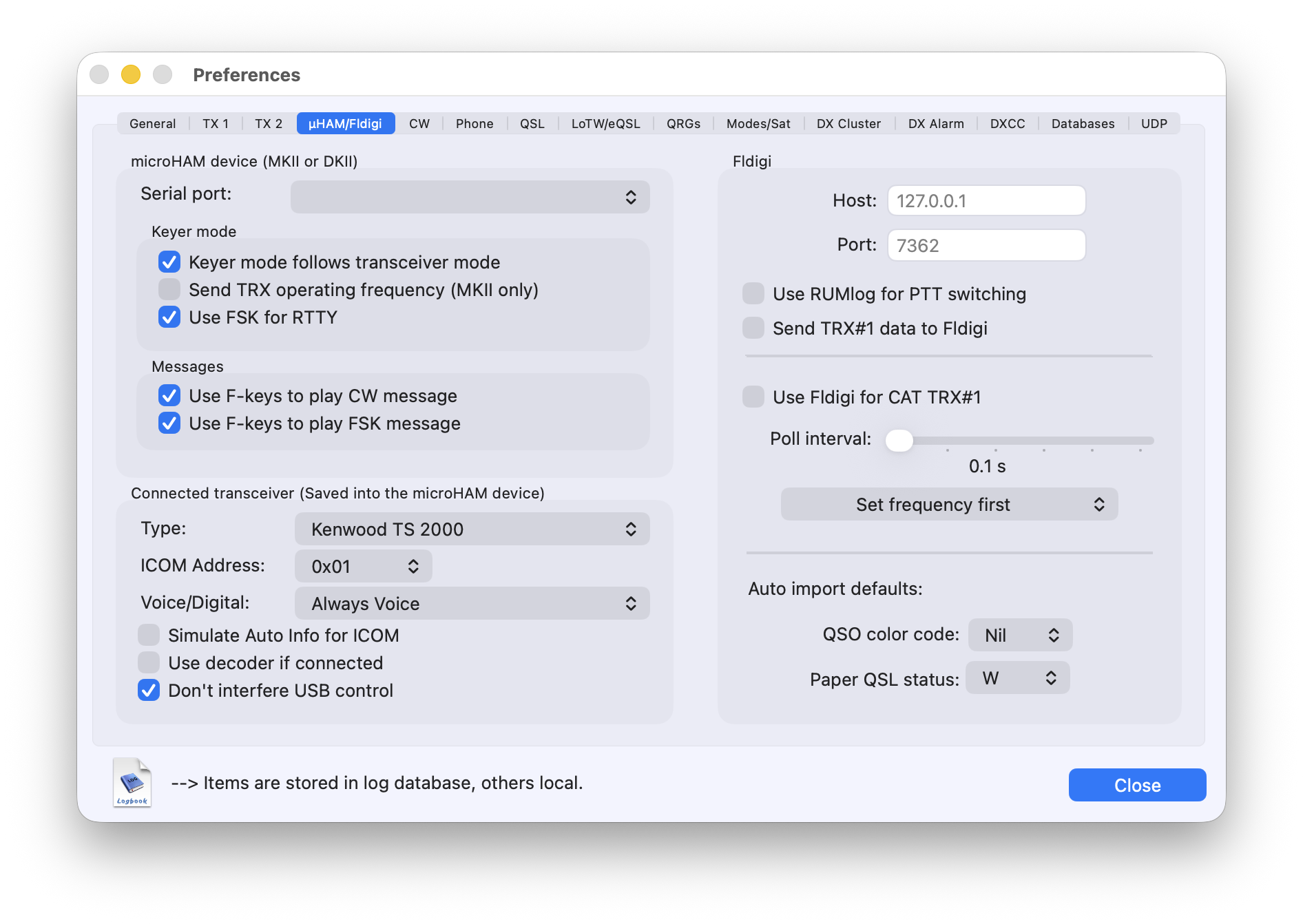

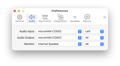

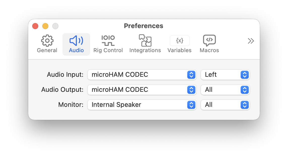

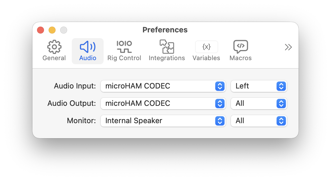

I have attached what I think are the relevant screenshots you want. I have limited this to idigi, as the behavior in it is exactly the same as in WSJT-X. The interface will accept only a few at time, so I will put them in separate messages.

Re: Rumlog and Microkeyer II, Can't make the PTT work
I'm wondering how iDigi can establish a dx-lab-suite commander CAT connection to RUMlog. In iDigi you have set the control port to 7374 and in RUMlog to 2237.
Watch the Network Status Window. When iDigi connects to RL, you will get a message.
