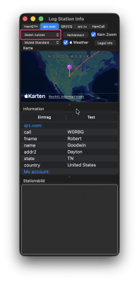

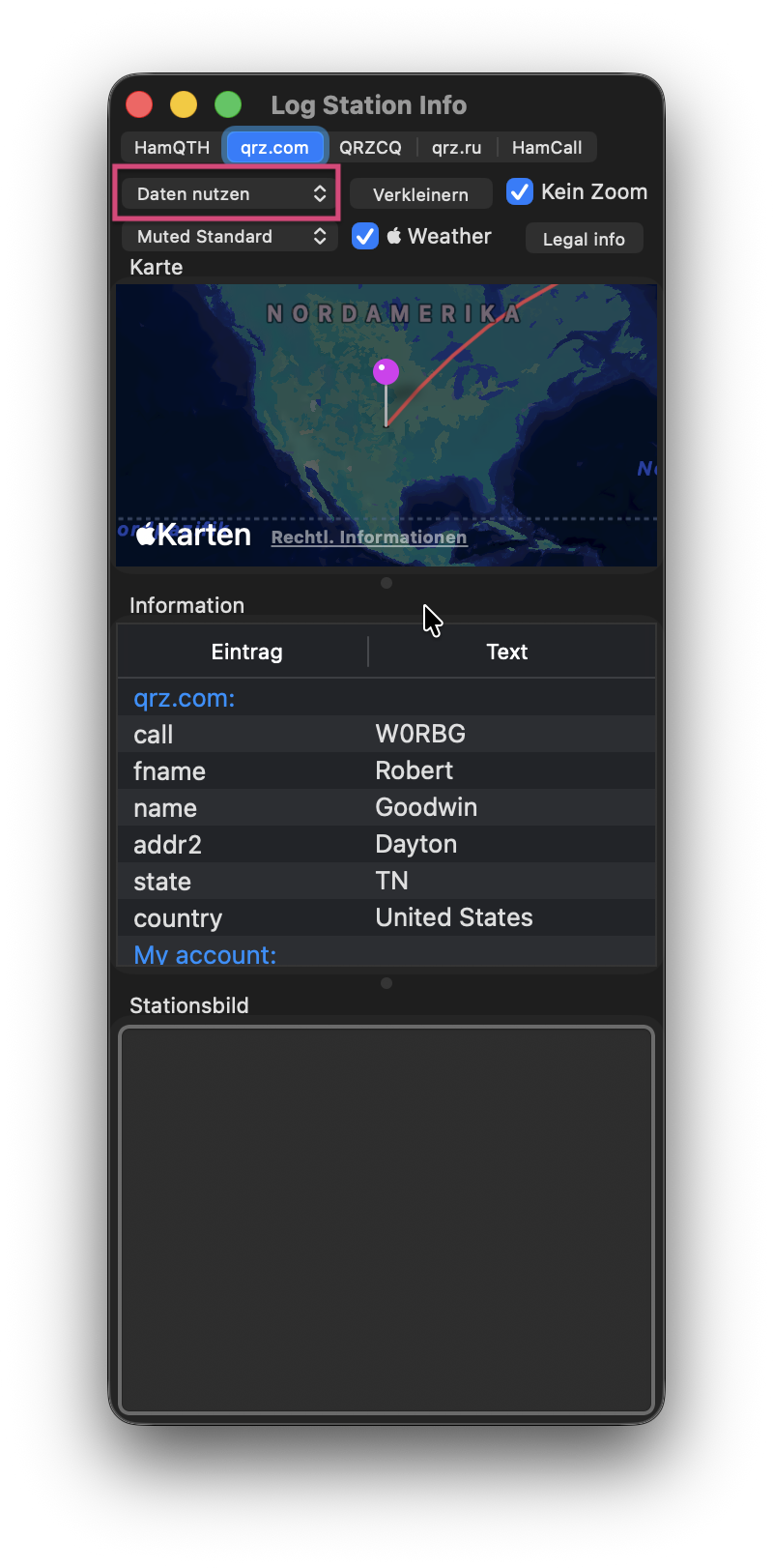

DL2RUM Thank you for the reply.
I can not find the "use Data" option in the settings. It is in the QRZ information that pops up after I click the ^ symbol. And after I click the ^ symbol the fields auto populate. What I was hoping for is an option that populates those fields when I tab past the call sign field without any additional steps.
I may be simply missing where to find the correct "use data" option.
I understand that in a contest situation this isn't required, but I have found it very useful in logging more casual QSO's and when operating POTA
73 W0RBG
Posts: 3110
Re: "Add QSO data" options are muted
Top of the Log Station Info window.
