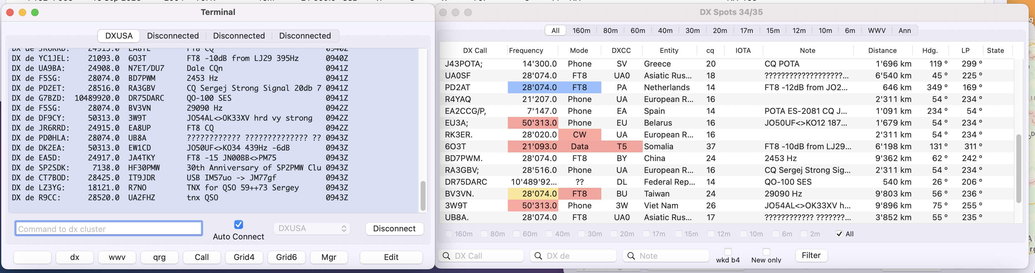

Here is a screen shot of the problem.
You can see the wrong character after the Call sign on the spot window, and the scrolling not at the end of the spot announced on the trerminal.
My filter is 80, 40, 20, 15, 10 and 6m all mode.

Re: DX Spot out of sync and wrong caractere after DX Call
It' explained here: https://dl2rum.de/RUMlogNG/docs/en/page ... Spots.html
I have to scroll down to see the last one on the DX Spot.
Make sure you have sorted the table by time (Ago column).
