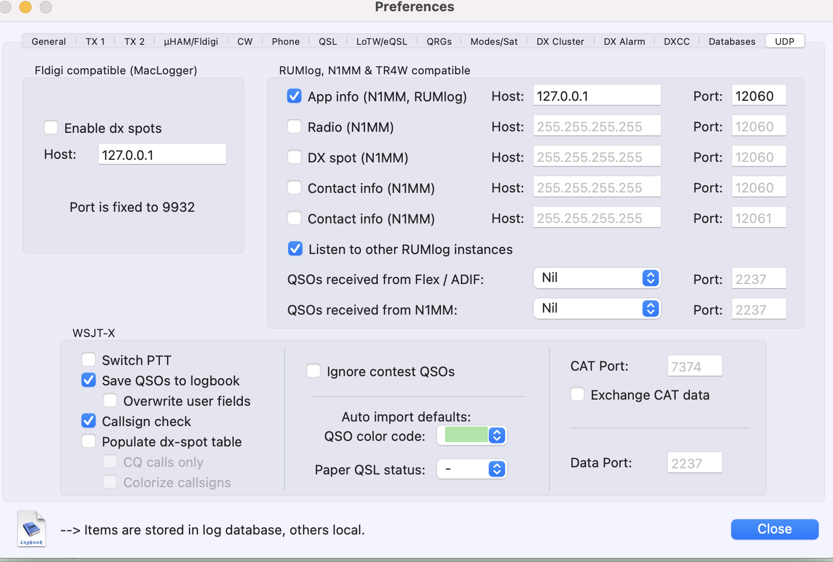

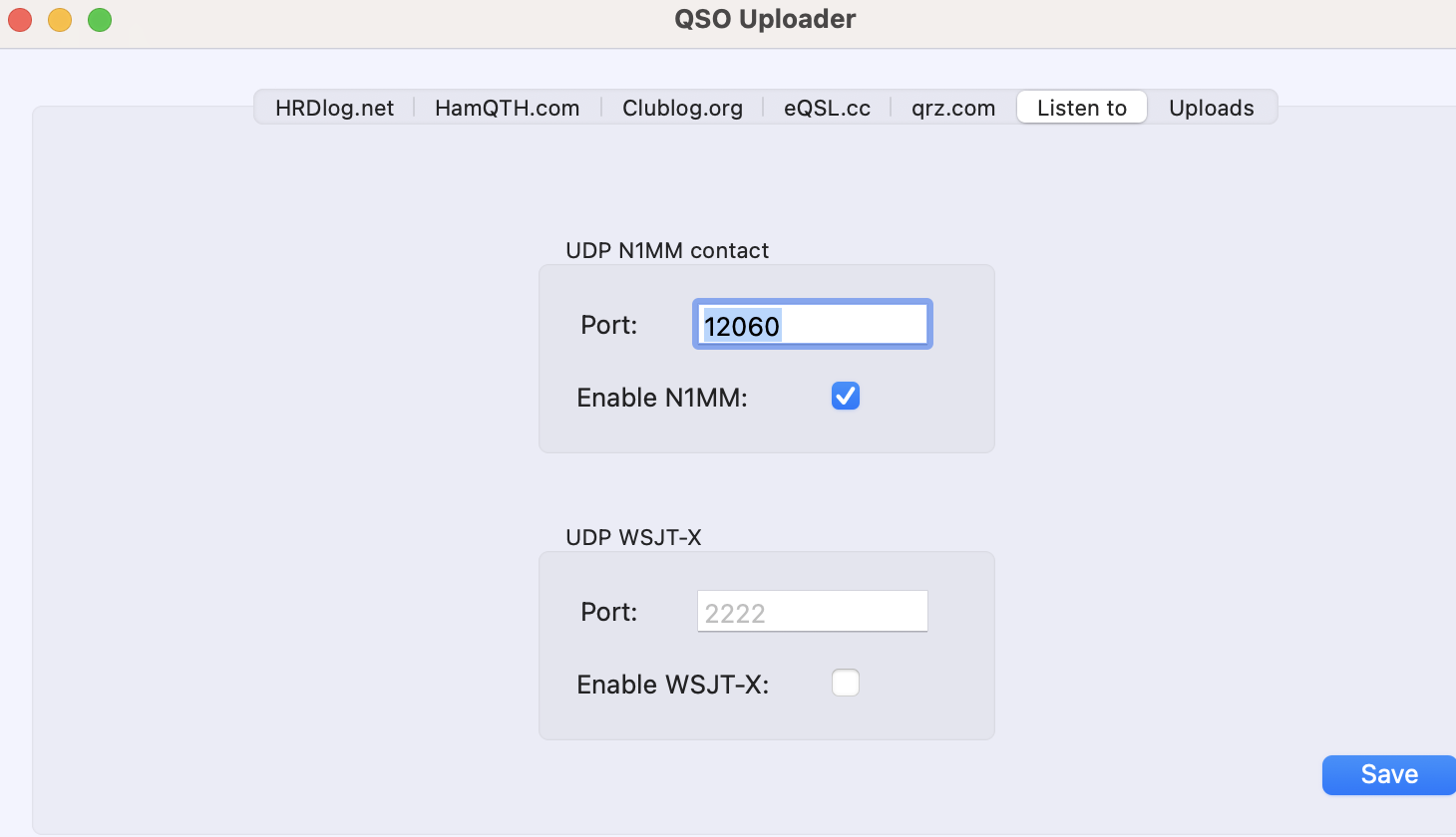

I went through what I found and from what I can see I need to set it up in Utility listen to UDP N1MM to port 12060 and enable ?
In RL Settings UDP select Ap info and listen to other RL instance in App info put my host on port 12060 ?
tried that but nothing sorry ?

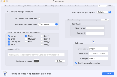

sorry Tom but help fie does not mean say much unless there is another help file top right of logbook
this is what I have Thank you

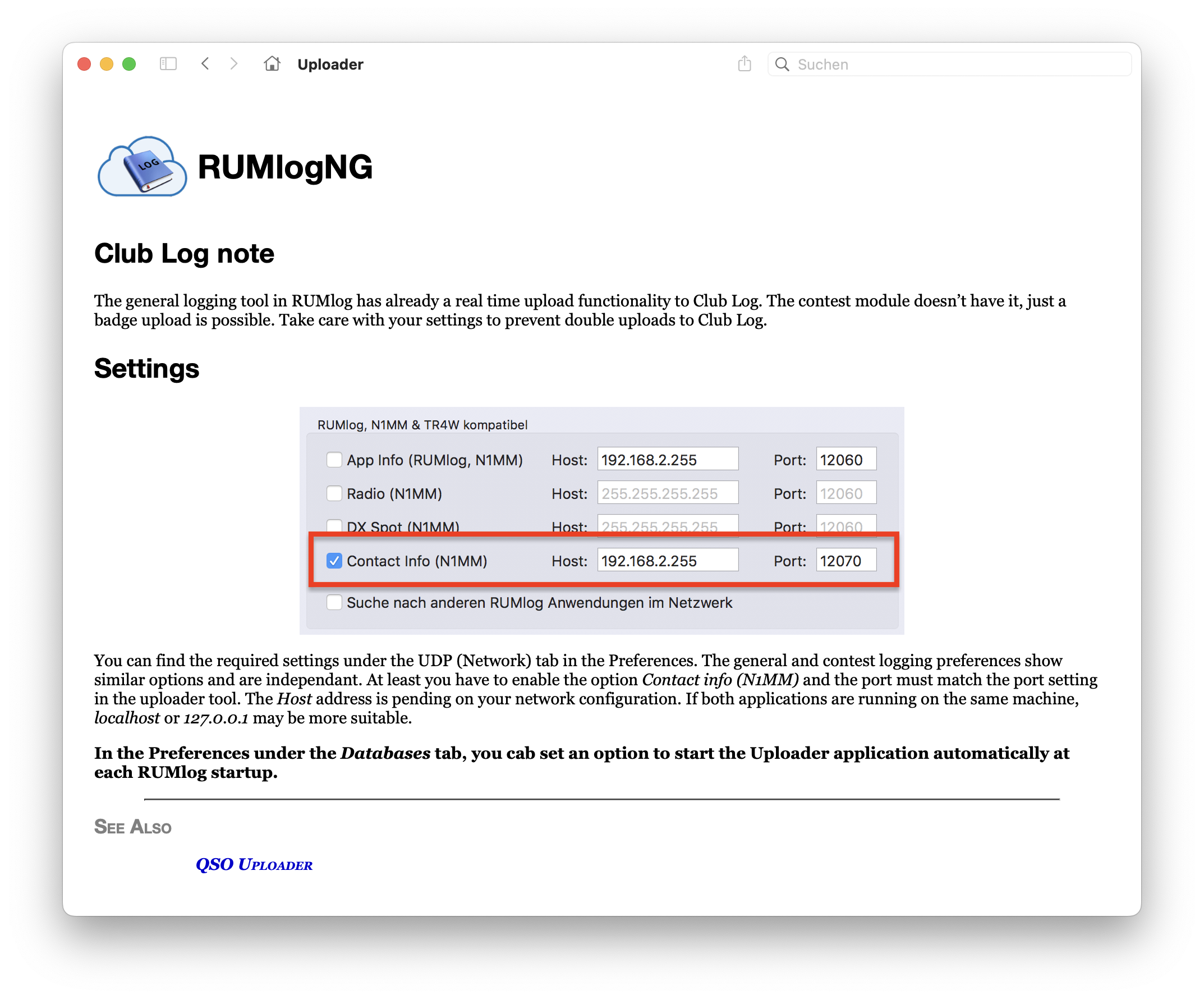

Attached picture from the Help file, do you see the difference?

Thank you Tom for you patience the photo shown in you response I do not see in the help file anyway all ok now Thank you

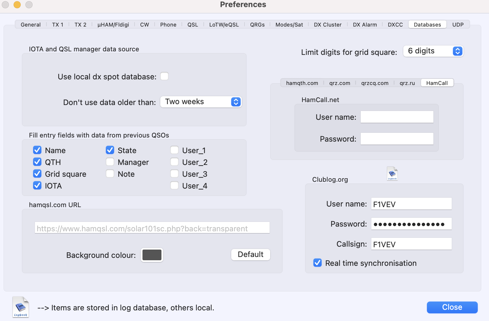

I do not have in databases tab the auto start for the utility ? but that is not a problem
Thanks again
