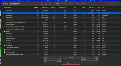

I have performed multiple tests before reporting here, following are my observations
1) the hang issue is observed even if the cluster connection is disabled .
2) hang issue is observed even if the QSO logs are entered manually ( SSB QSO) where there is no UDP broad cast from the SmartSDR for Mac.
Activity Monitor from the M1ac is attached here, this screen shot is taken when the RumlogNG starts hanging. It appears the resource consumption at the time of application hang is at normal levels.
Appreciate any help in solving this problem
