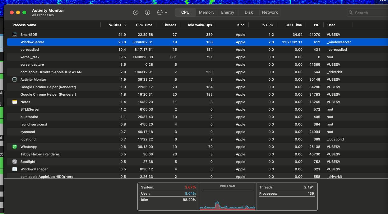

Activity Monitor from the M1ac is attached here, this screen shot is taken when the RumlogNG starts hanging. It appears the resource consumption at the time of application hang is at normal levels.

I also read about Google accounts if configured, takes lot of resources through their contacts. I also noticed a contactsd in activity monitor hogging lot of CPU resources and killed it and disabled contacts on all my google accounts configured in accounts. The crashes are less frequent now, but it's there still.
