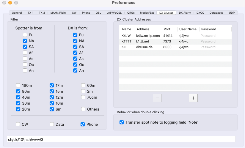

I tried the test with the same results-attached is the crash log. I also removed all the cluster connections and it recreated the one for Kiel so I turned off auto connect and it doesn't crash but if I enable it, it crashes within a minute. I added a cluster back in and after connecting, it crashed with in a minute. I have a screenshot of my cluster settings included as well.

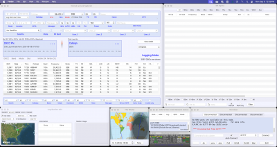

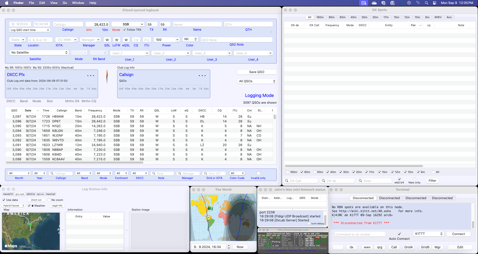

No SDR radios. My main home radio is the 991A. I have the Logbook, The WORLD (grayLine), Sun (HamSQL.com), Network Status, Log Station Info (QRZ & HamQTH) along with the terminal and DX Spots window as seen below. This is usually on my second display-the primary has my browser, email, etc open.
