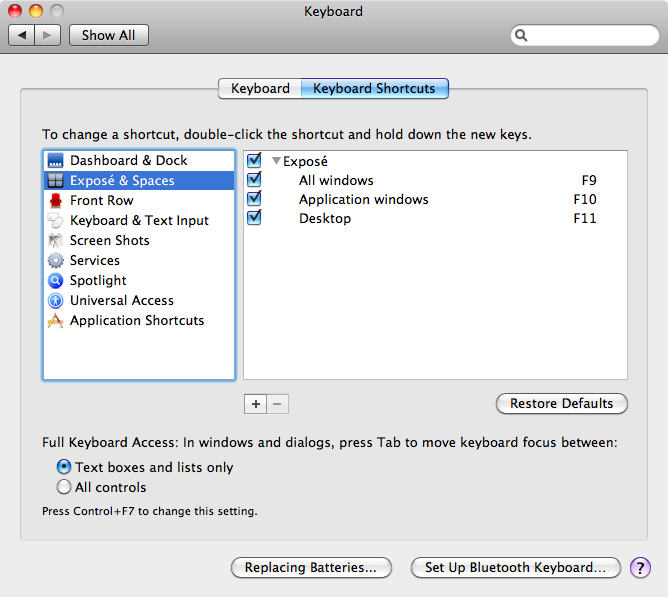

Seems like several things got messed up when I tried to use the F5 key for CW. Including not working from the keyboard but sending from the CW control panel.
After a reload of the program things are back to normal. (except still can't send with any "F" keys higher than F4 - I'll just use the control panel for them).

Re: LoTW Indicator
Apple recommends not to use the F keys in own applications. When you have configured your system to use the F keys for OS-X (Spaces, Exposé, etc), then these keys are not visible in RUMlog.

I have the "F" keys set to be regular "F" keys instead of special ones and F1-F4 work fine but none above that.
Not a big deal, I'll just use the CW Control panel

Re: LoTW Indicator
This is another story, you have also to disable all other short cuts assigned to the other F keys in your system
preferences.
