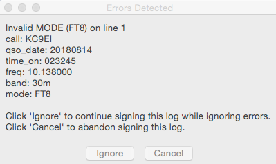

Well it was working but now I get this when attempting to upload LoTW -- any idea what causes this?
Re: RumLogNG FT8 and IoS 10.10.5
Do you use the latest tqsl version 2.4 and the latest configuration data 11.5?
Otherwise, there was a bug in an older RUMlog version causing this. You can e-mail me your logbook file, maybe I can repair it.

Ok, installing new TQSL version and config and will see how it goes...

Well after installing 2.4 and 11.5 updates TQSL now reports no certificate. I have requested a new certificate. Hope that gets me up and running with RumLogNG.

New certificate installed and RumLog is able to connect to LoTW again. Thanks for your help.
