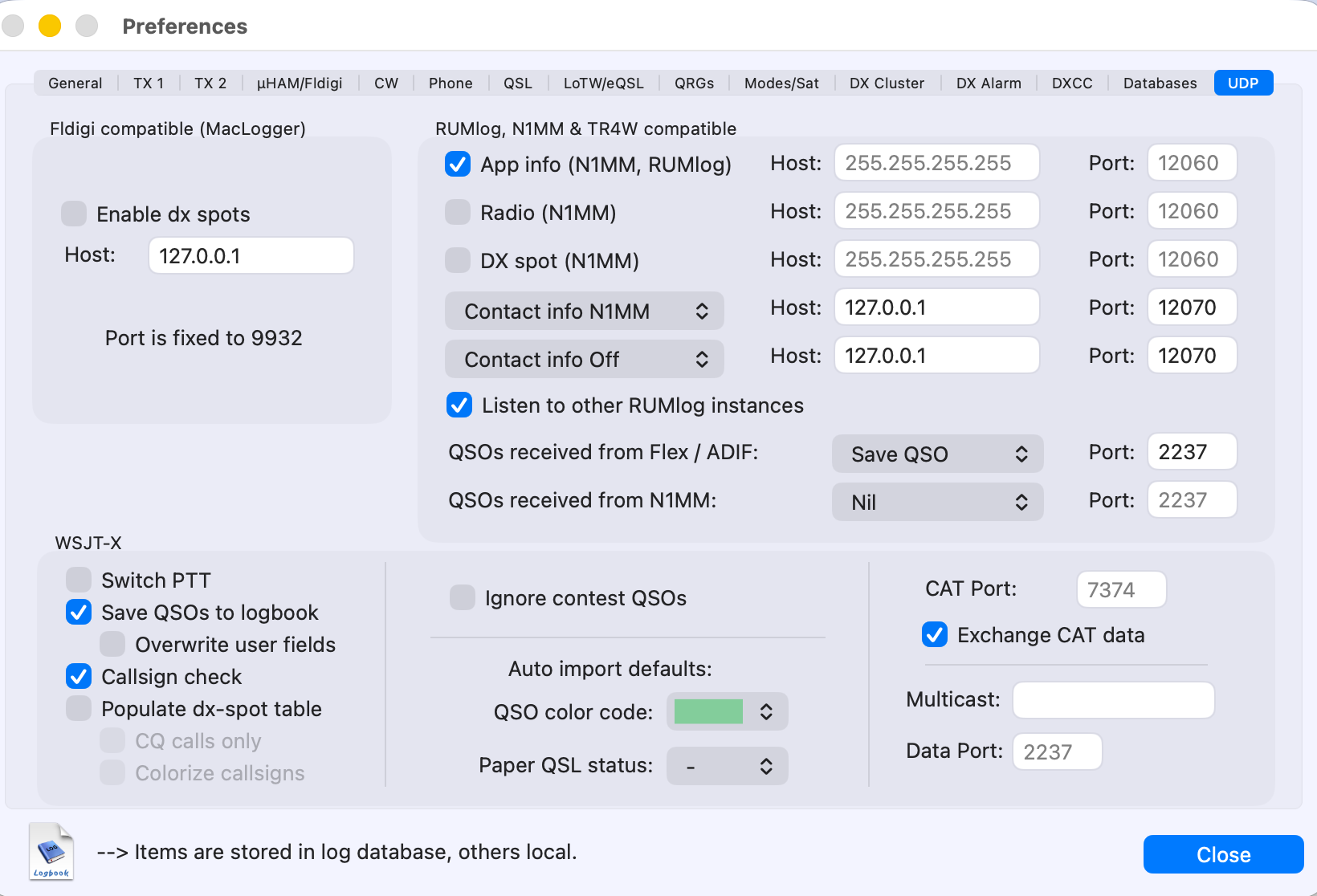

Unfortunately it's still not working. Here are the settings

Posts: 3110
Re: Issues with QSO upload and details fill.
What are your intentions? When you want to upload QSOs logged from RUMlog you have to enable the appropriate options.
See the Help for the upload utility.

HI see difference in your first post between yours and mine

DL2RUM wrote: Fri 17. Apr 2026, 15:17 What are your intentions? When you want to upload QSOs logged from RUMlog you have to enable the appropriate options.
My intention is to automatically upload new logged QSO in RumLogNG to qrz.com. On previous mac, I don't remember I was specially configuring something besides api key for qrz.com
Could you point me to the QSO Upload Utility documentation.
Found the documentation, now it's working. Thank's for the help
Menu-->Help-->QSO Upload Utility Help
