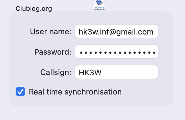

Hello Tom
Clublog's real-time synchronization is not working
I've imported ADIF file with new QSOs, but when I tried to upload them to Clublog it says that there is no new QSOs.
Im use this:
MacBook Air M4 (2025)
Which macOS version? TAHOE 26.1
Which RUMlog version? Version 5.20 (690)
Do you use your login password or your App password? I use Clublog App password.
Do you log in with callsign or with e-mail address? I Use E-mail address
Do you have special characters in your password? Not special caracter
Posts: 3108
Re: Clublog upload issue
When you have activated the real time sync feature, there is no need for a manually upload. Check your log in Club Log.
You can always force a second upload by selecting QSOs in question and using the menu command.
