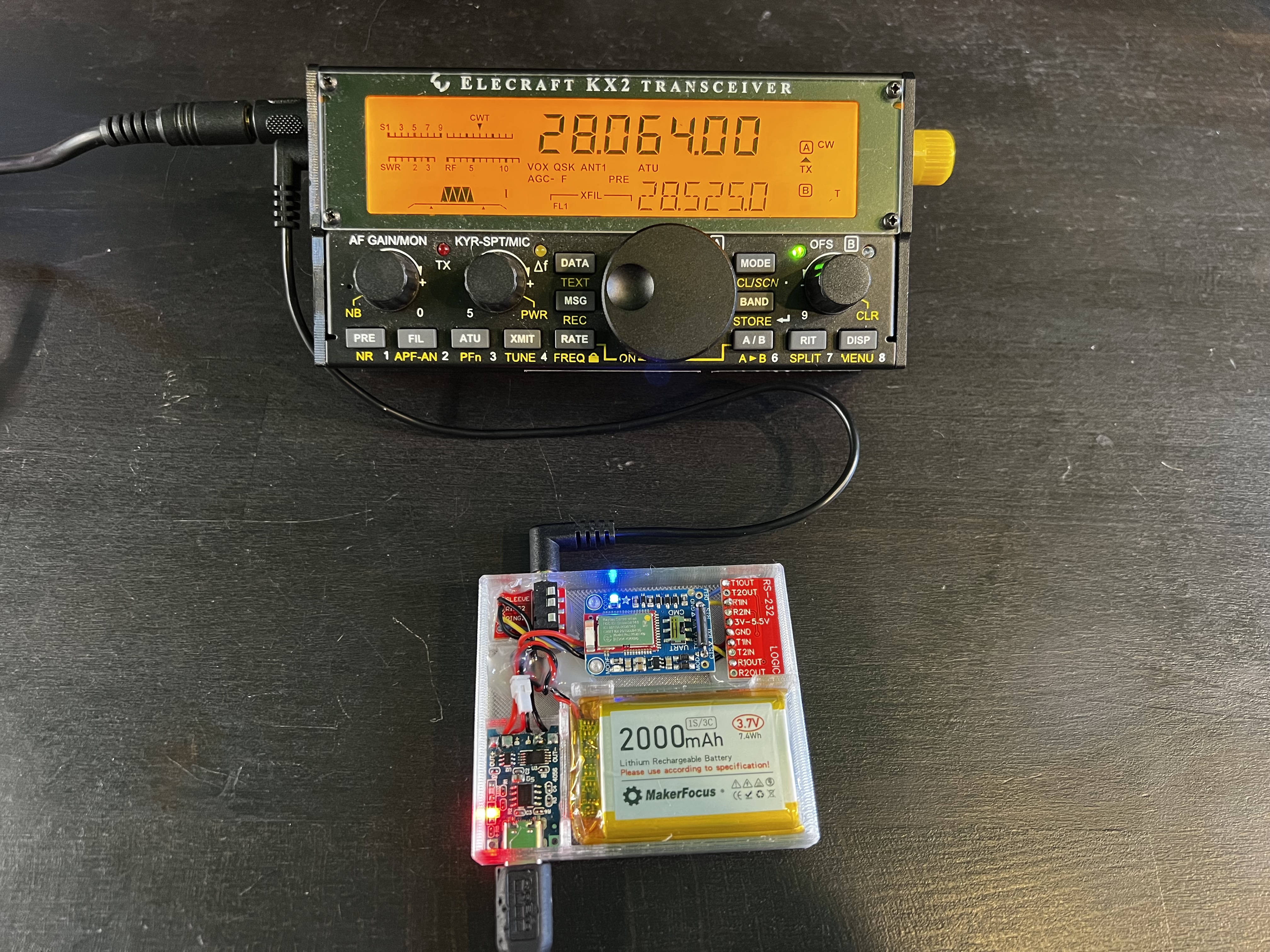

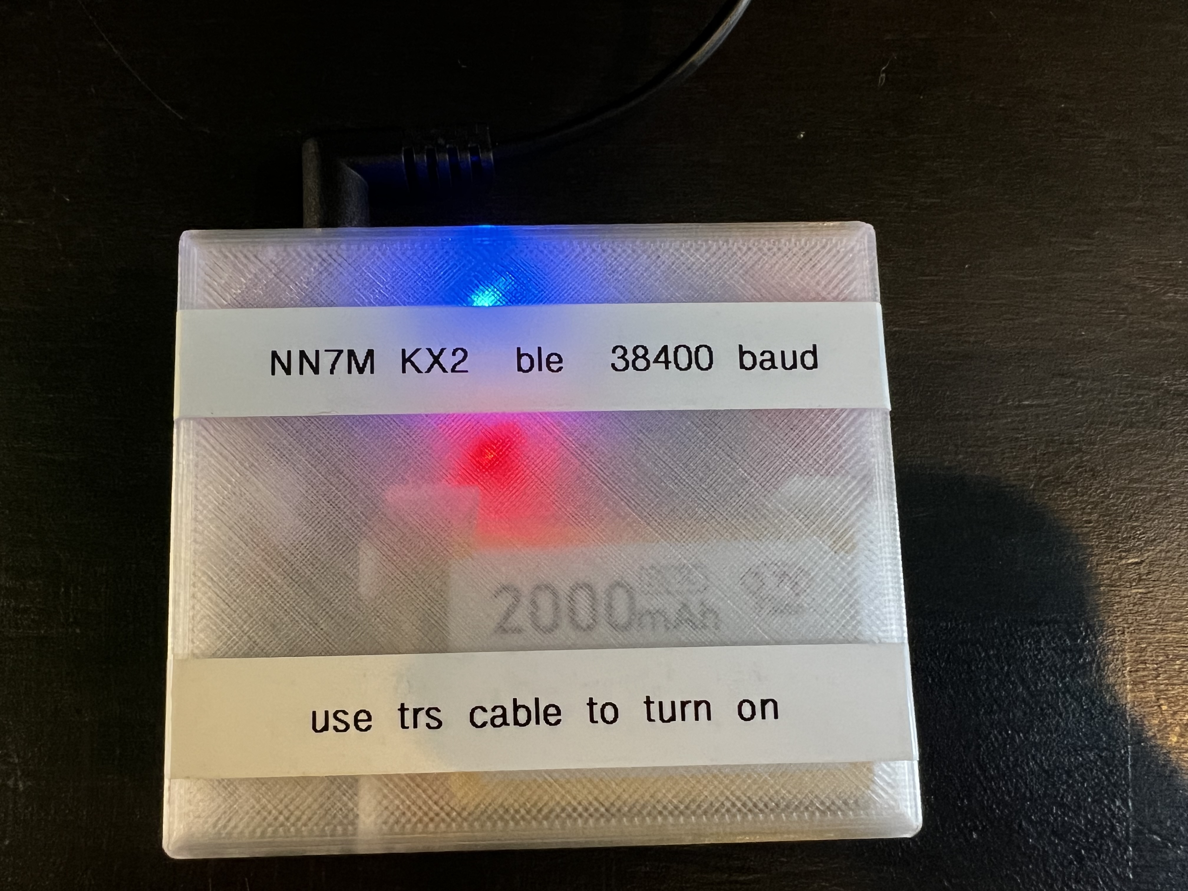

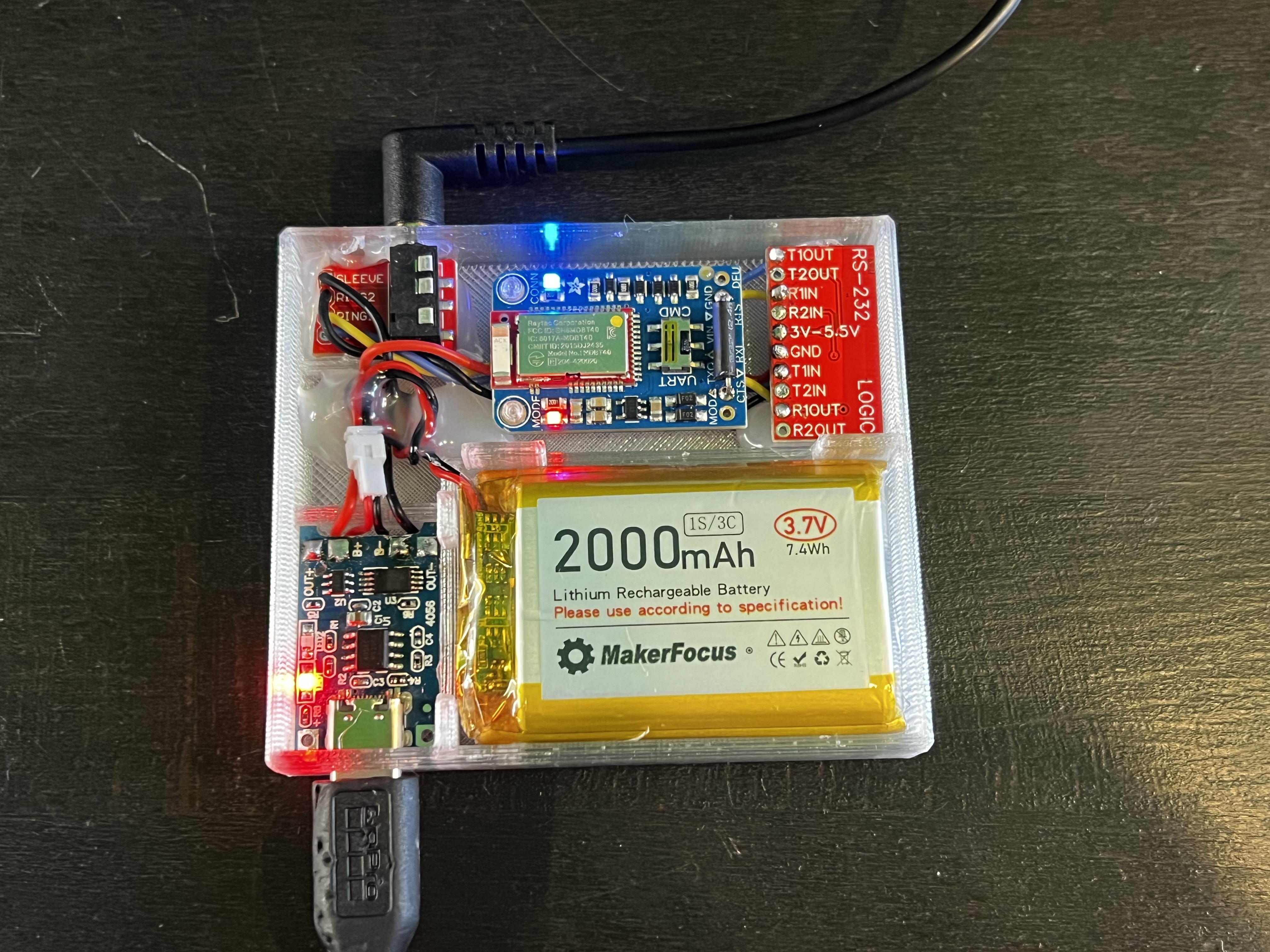

I designed a 3d printed enclosure for the CAT interface. It is published on Printables. You can download the files here:
https://www.printables.com/model/119609 ... mlogng-rum
