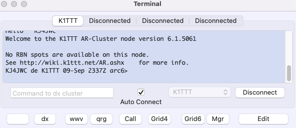

Does it really crash always after a minute? Pse post a screenshot of the dx-cluster terminal window after the crash.

Delted previous test, opened new one. Ran for 45 seconds and crashed. Attached is the Crash log and below is screenshot before it crashed on the window.
