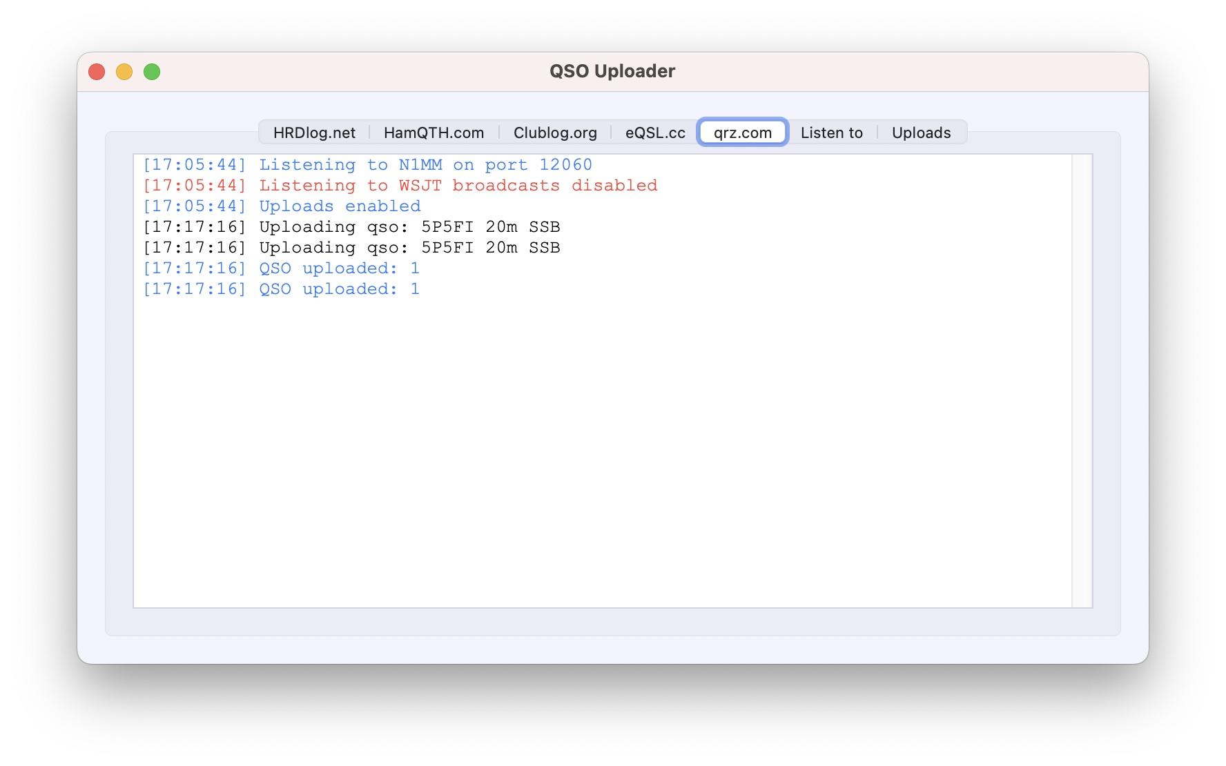

Re: QSO to QRZ upload
Unread post by iz6fxs »
It seems that my QSO are all uploaded doubled... Where am I doing wrong. It also applies for HRD log, club log ecc... Thanks!
Posts: 2990
Check your network UDP broadcast settings.
iz6fxs
Joined: Sun 12. Feb 2023, 13:44
Can you spot the misconfiguration?
Thanks!
Norm
Posts: 2990
Not yet.
But i have seen this before, when you are connected twice. Via LAN and via WLAN.
iz6fxs
It is very much possible on the iMac. As you may know, disabling WiFi is going to stop Airdrop and maybe other things from working... Do you have a suggestion?
Posts: 2990
Pull the plug. Or try localhost instead of broadcast it to the whole network.
iz6fxs
Thanks, it worked! But I'd think in adding interface selection in preferences ;)
