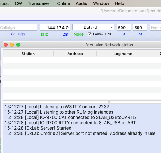

but still same problem:
tnx oz1jmn Allan
Posts: 3131
Re: IC9700 and wsjtx problem
13:53:24 [DxLab Cmdr #2] Server port not started: Address already in use

where are DxLab Cmdr #2 starts ? when i start rumlogng solo it give me:

Posts: 3131
Do you have setup another server under the UDP tab?

Posts: 3131
You don't see that the port 7374 is used twice?
