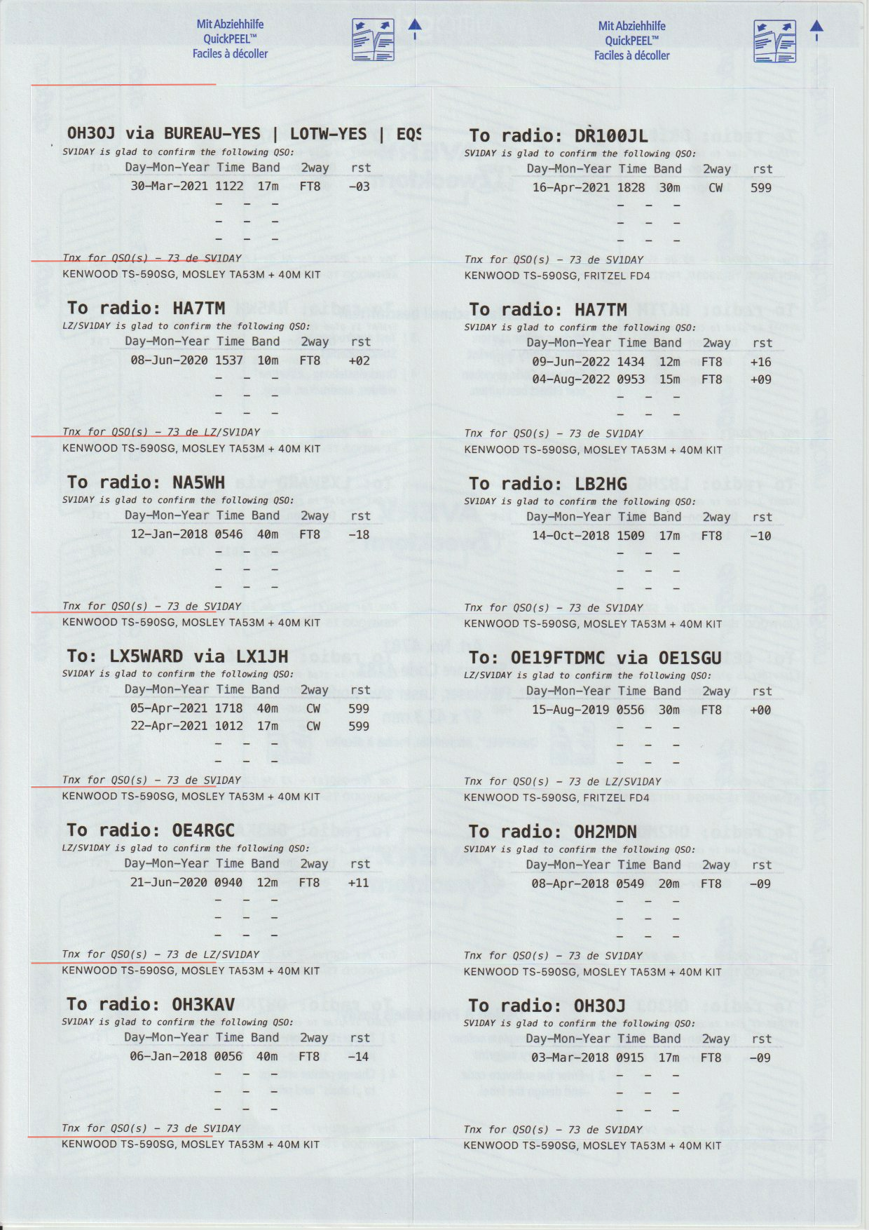

Using RUMlog 5.10.1 (546) I printed some QSL labels on a AVERY #4781. The last line though goes onto the next label. Look at the scanned A4 labels sheet, where I have marked with light red lines the labels separation.
It seems that there is larger margin at the top of the page, but I found no means to trim it. Menu>Edit>Page setup is A4, Portait, Scalling=100 Format for "Any Printer".
Am I doing something wrong?
73 de SV1DAY
Posts: 2990
Re: Labels AVERY#4781(97x42,3mm)
You have to create and select a custom paper with all borders set to 0.0. Make sure you have chosen this paper before you open the Paper QSL out dialog.

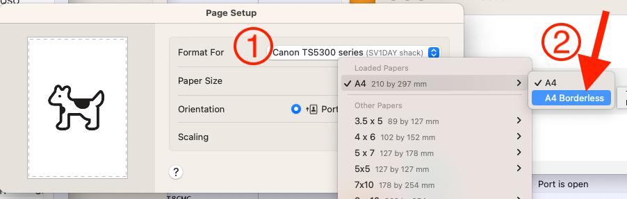

Thank you dear Tom! I also thanks Hanz, YL3JD for his hint. Actually I had to make two changes:
1). I changed the printer from "Any Printer" to the specific one I have (a CANON inkjet)
2). Then and only then, the options for A4 Borderless paper was visible. I selected A4 Borderless and the issue was resolved.
