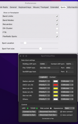

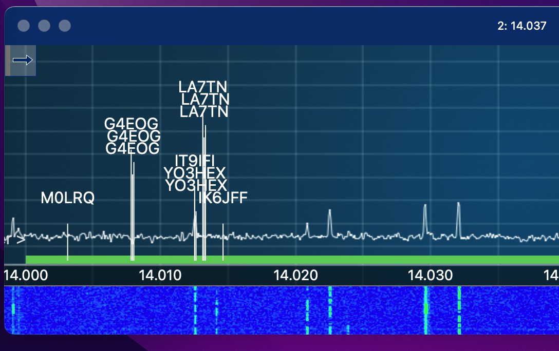

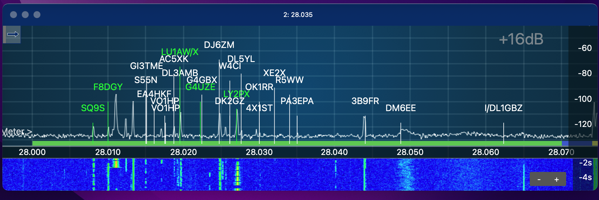

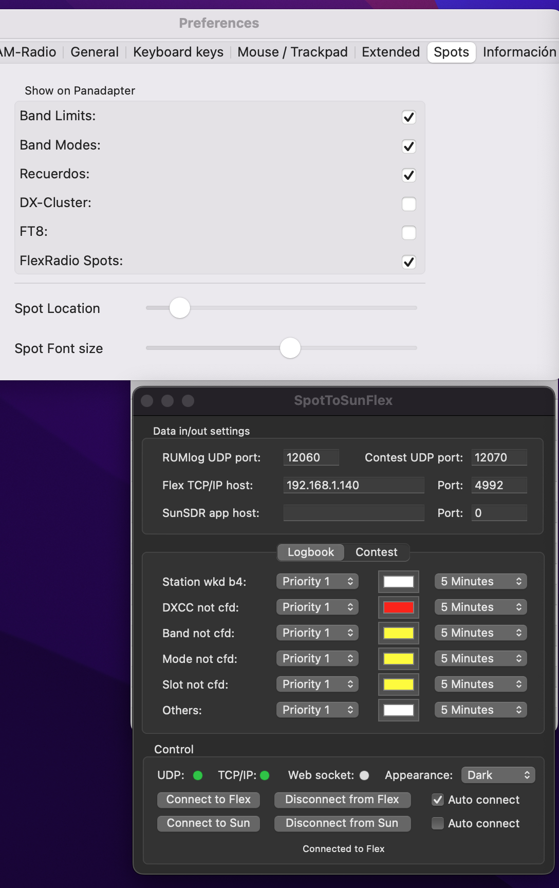

Hello all,
I am testing the new app SpotToSunFlex, it works but it generates duplicates of the Spots, as time goes by it generates many more duplicates. I have tried to change the priorities but it keeps happening. What am I doing wrong? I attach a couple of photos of my setup
Tks in advance
73's Ignacio, EA4OR.

I haven't seen this before. The app just sends dx spot to the Flex, the spot management itself is under control of the Flex software. Do you have configured multiple dx-cluster sources?

Tom, thanks for your fast answer.
I am not using other dx-cluster sources. At least consciously.
I am a new user of SmartSDR and RUMlogNG, I am learning everyday, I need time to find my setup.
An example of this is that after my post I found the option to send the spots directly to my Flex from RUMlogNG without using the SpotToSunFlex app, now it is working better, only occasionally a duplicate appears.
Tks for your help ;)
