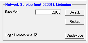

In Rumlog I have it like this so that it transmits it via UDP (tested with the IP of the PC and with 192.168.1.255).
And in DxLab it listens to the same port, but does not receive anything.
View attachments
I am doing something wrong ...?

Dxkeeper
Captura de pantalla 2021-05-23 205532.png (2.51 KiB) Viewed 3176 times
Dxkeeper
Dxkeeper
