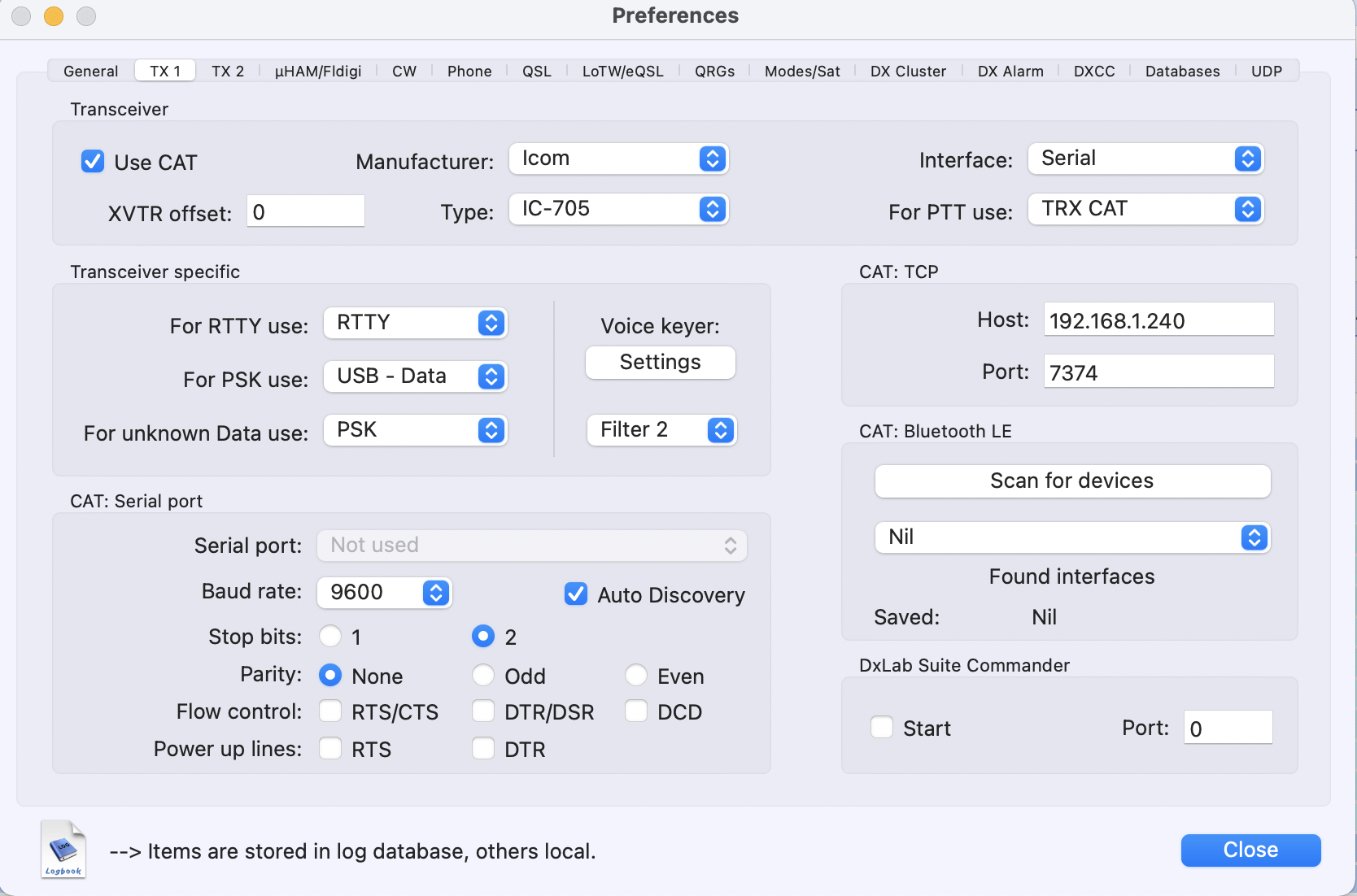

Thanks for the VERY quick reply. It's too bad the iPad and IC-705 can't "talk" to each other. I'd much prefer to take it into the field than my MacBook Pro.
The IC-705 and my MacBook Pro are connected via Bluetooth ... the IC-705 says connected within the Bluetooth menu (Bluetooth icon also illuminated on main screen). In the MacBook Pro Bluetooth menu, it shows ICOM BT(IC-705). However, within RUMlogNG, "Scan for devices" comes up empty. It's apparently not "seeing" the IC-705: I've tried with both Serial and Bluetooth selected in the Interface menu, also with Use CAT selected and not selected with no success. Any help on settings would be greatly appreciated.

Serial as Interface is correct!
Use 1 stop bit only.
Of course, the Auto Discovery can not work with Bluetooth, deselect this option.
From the Serial Port popup select the BT port, it is called something like Icom BT-IC705

Eureka! Thank you VERY MUCH for your help. I was focused on expecting to see something in the CAT: Bluetooth LE section. The serial port option that worked was "Bluetooth-Incoming-Port" and once selected, the logging window followed the IC-705 band, frequency and mode. Perfect!
