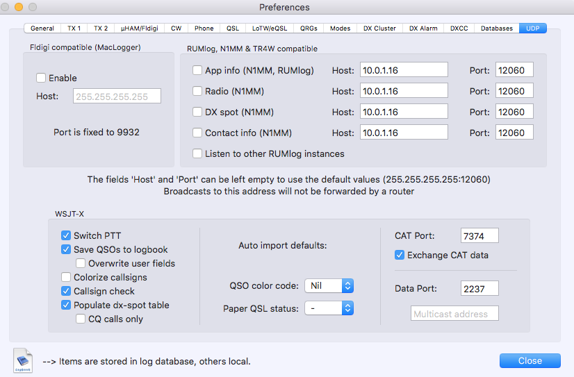

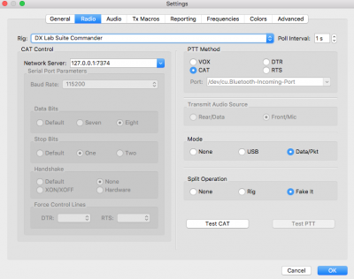

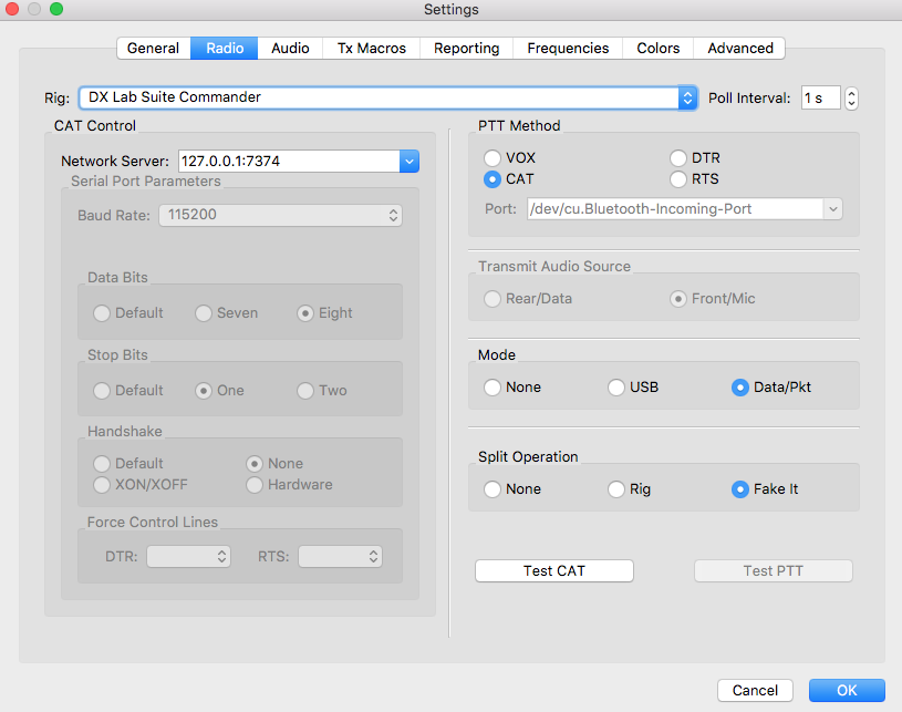

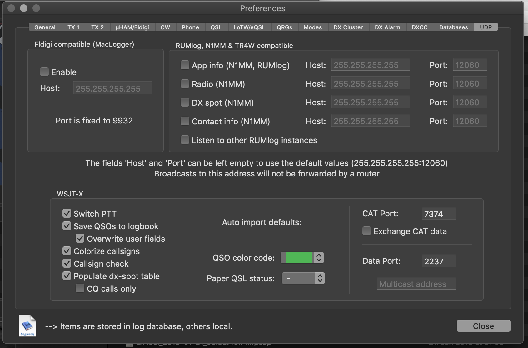

Hi, I suddenly noticed that current version is not accepting VFO changes from WSJT-X program, hence the Fake Split operations in WSJTX is not operational anymore. It seems to me that its the RumLogNG side which causes the program. Appreciate if you can check. 73 de LA0FA

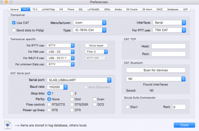

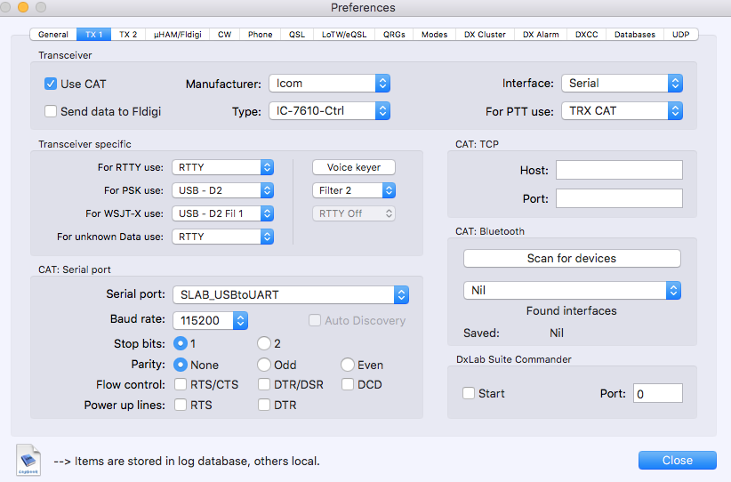

IC7610. I have added screenshots for TRX/UDP from RumlogNG and Radio from Wsjtx.

Posts: 3086
Re: RUMlogNG version 4.4
Which exact RUMlog version do you use? See the About menu. Do you have configured two transceivers? I'm wondering, your Auto Discovery function isn't available (grayed out in your screen shot?). The port name could change every power up and the Auto Discovery will fix that problem.
Further more you have set two PTT options, this may cause trouble. When you enable CAT as PTT Method in WSJT-X the tcp/ip CAT connection will be used. A working CAT connection is required.
When you enable Switch PTT in the RUMlog UDP settings, RUMlog watches the PTT status via the UDP broadcasts. A CAT connection is not required.
But I can't duplicate your problem, I use the IC-7610 here as well. I tried your settings with success. I got few reports with the same problem, so I guess there is a real issue. But I never got a feedback, maybe the problem is gone.
Try this:
  • In RUMlog deactivate Exchange CAT data in Preferences-->UDP-->WSJT-X
  • In RUMLog activate Start in the Preferences-->TX1-->Dx Lab Suite Commander
  • Watch the Network window for status messages.

Hi again and thanks for all suggestions, I have tried them all and the problem remains. As I do not keep any of the older versions of rum log so I don't know when this feature stopped working. I use the latest 4.4 (355). I have also changed the PC - on my iMac I have High Sierra and on my MacPro I have Mojave but its the same on both. By the way: the auto discover only works on Mojave. So until further I will have to operate the wsjtx without split parameter and rather modulate with the real audio frequency. I don't operate a second TRX.

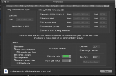

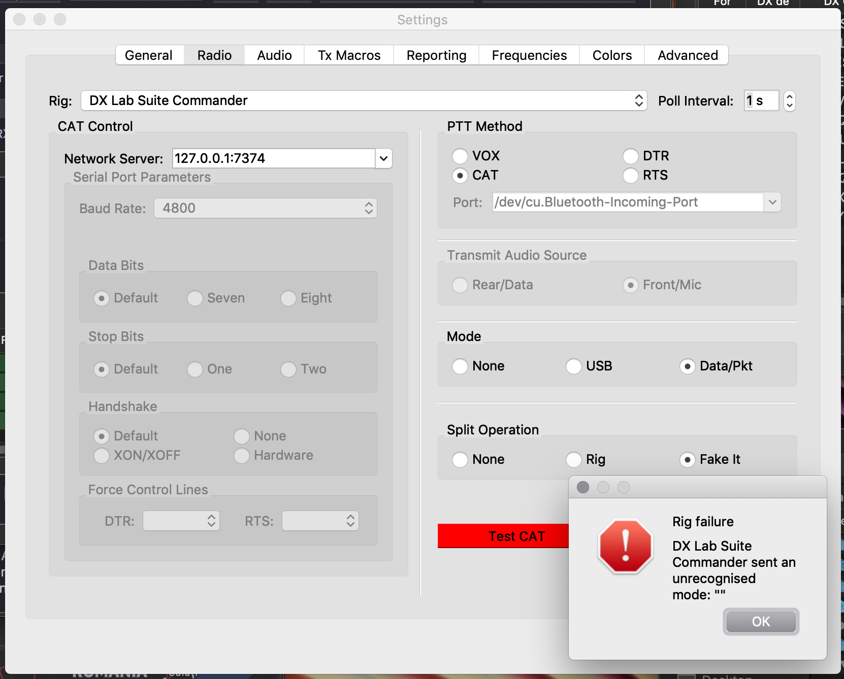

I'm seeing a similar and possibly related issue, rig control in WSJT-X stopped working.
Setup:
macOS Mojave 10.14.6
WSJT-X v2.1.0 24fcd1
RUMlogNG 4.4 (355) using these settings:
Network Status messages:
20:34:47 [localhost] WSJT checked in
20:40:37 [Local] Listening to WSJT-X on port 2237
[DxLab Cmdr #1] 20:40:50 Connection established to: localhost
20:40:54 [DxLab Cmdr #1] Closed connection to localhost: Socket closed by remote peer
WSJT-X shows this error when trying re-enable the Rig in the Radio configuration tab:
This setup was working in the previous version (installed and updated from the App Store). If there's any other information from logs that I can collect or if there's something I can do to help debugging the issue please let me know.

Posts: 3086
Can you still set the trx mode and frequency from RUMlog? (double click on the frequency from a dx spot, or just enter a frequency into the callsign field).
I appreciate any help, I would prepare a version to find the problem. I would continue the conversation via e-mail.
