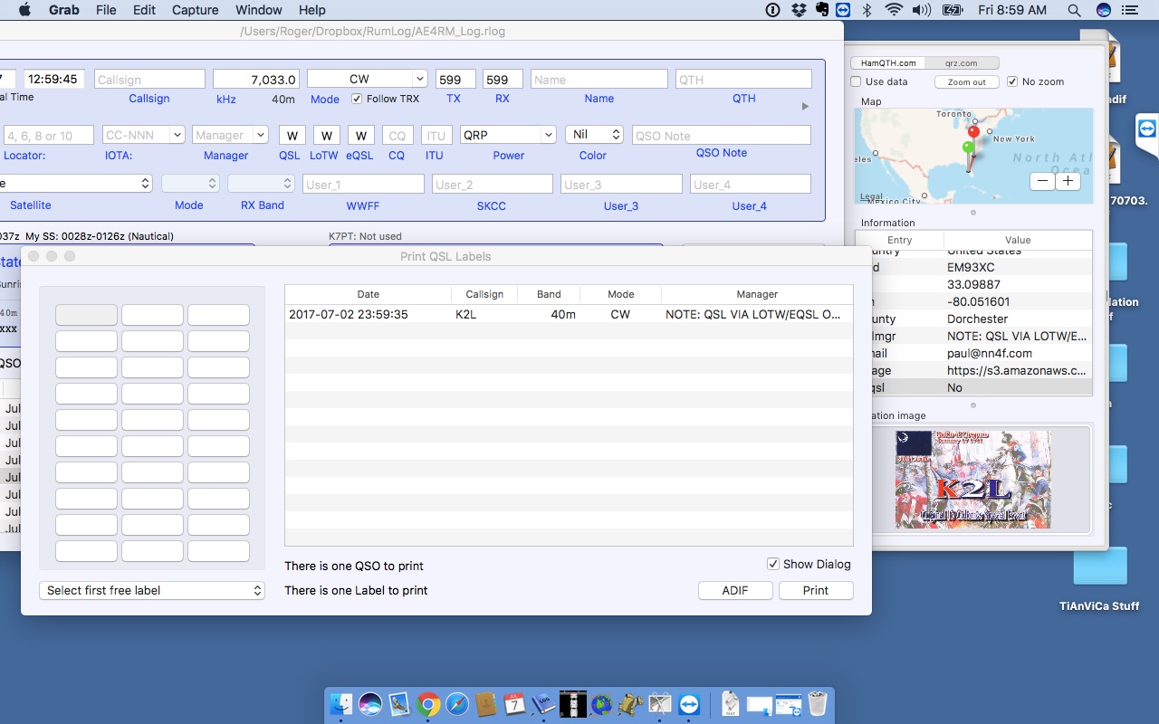

The printing is fine. Its picking up the QSL manager from QRZ.com when it pulls the address. I have attached 2 examples. The jpeg is the print screen showing the QRZ data on the right side as well. The second is the PDF of the resultant label.
I would just like the option of not pulling in the QSL manager info since it seems to be incorrect many times.
