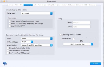

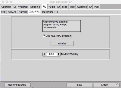

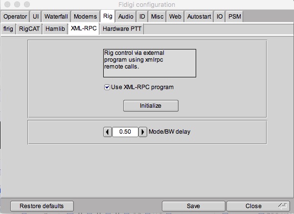

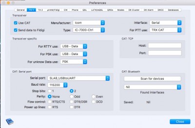

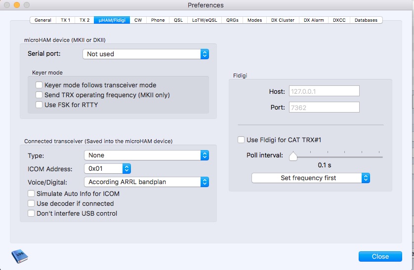

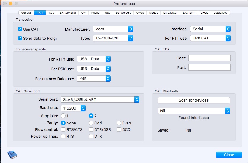

I am having a similar problem. I can not set Fldigi to track my 7300. RumlogNG is tracking just fine using the 7300 console. I am a long time user of DXLabs and am trying to make the switch to RumlogNG. Like Ron I have DXLabs Commander and WinWarbler working with the 7300. I believe I used some of the macros Ron provided for Commander. I have attached my setting. I am using the latest Mac Sierra beta.

Tom, you have to enter the Fldigi address data into the RUMlog preferences under the FLdigi tab.
nineback
Joined: Sun 17. Aug 2014, 20:22
Re: RumlogNG & IC-7300
Unread post by nineback »
Too easy. :-) It is working now.
