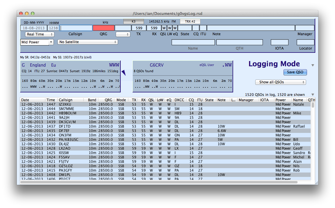

Ahh! Interesting. RUMlog is seeing the radio but not entering it in the frequency field. The field stays red, even if I enter a callsign and hit the TAB key. The screenshot shows this
