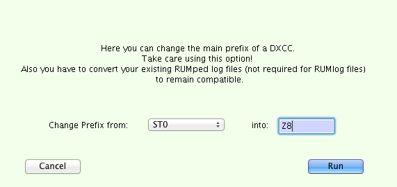

To convert ST0 to Z8:
  • Quit 'RUMLog' and start 'EditDXCC'.
  • Backup your log file the the 'dxcc.rsd' database file
  • In 'EditDXCC' select Menu-->DXCC-->Change DXCC Prefix
  • Select your currently used prefix for South Sudan from the popup menu
  • Enter 'Z8' in the right hand text field
  • Press the 'Run' button

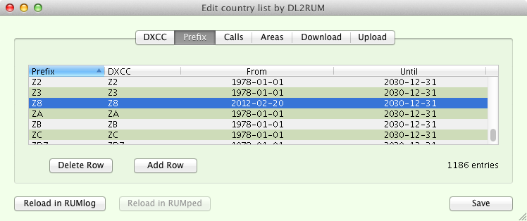

Now we can add 'Z8' to the prefix list:
  • Select the "Prefix" tab
  • Press the "Add Row" button
  • Enter the data as shown below
  • Mouse click the Prefix header row to sort the table by the prefix - for your convenience only
  • Press the "Save' button

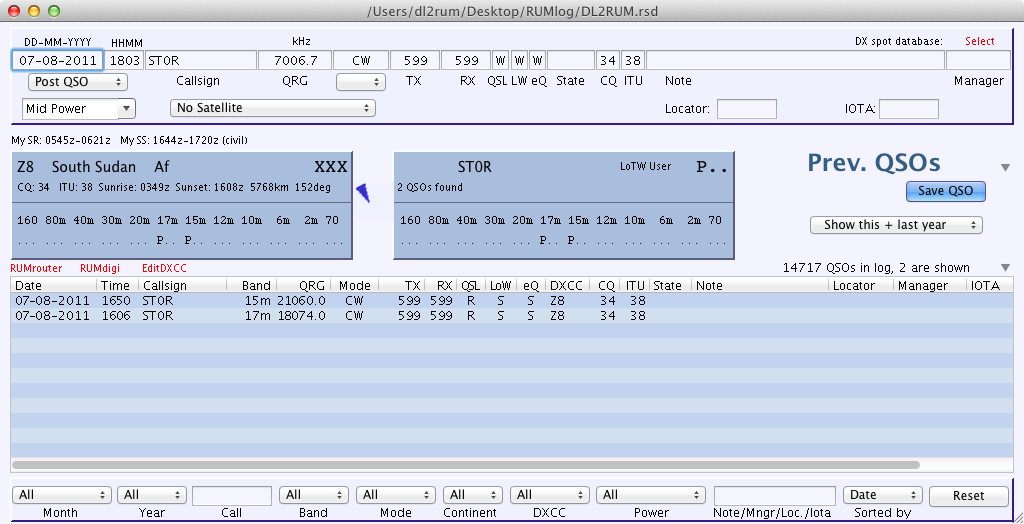

Now you can start 'RUMlog' and all South Sudan QSOs show up as 'Z8', no further action is required.
