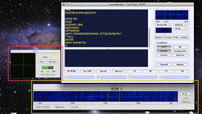

Sorry, I still don't understand if the crossed bananas are supposed to appear on the Rumlog screen titled "cocoaModem - Tnx Chen, W7AY" or on the CocoaModem sceen titled "cocoaModem 2.0"

The Control button brings up the red marked control window, the "Open Controls" button on the cocoaModem main window has the same effect. The window button toggles the yellow marked main window.

I do not get the red marked window, nor can I find the "Open Controls" button on the cocoaModem main window. I have cocoaModem 2.0 v0.95. It is not a big deal, and I would just as soon not even evoke the cocoaModem main window. How does the tuning indicator in the lite screen work?
