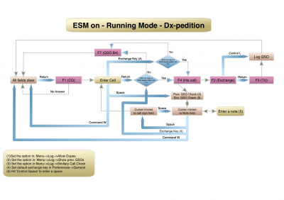

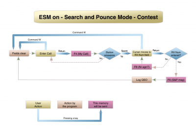

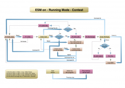

I've tried to create few flowcharts. Maybe it is helpful. I added also the graphics as a pdf file.
ESM-Contest-S&P.pdf
(71.27 KiB) Downloaded 1638 times
ESM-Contest-S&P.pdf
ESM-DXped-Running.pdf
(104.18 KiB) Downloaded 1561 times
ESM-Contest-Running.pdf
(121.54 KiB) Downloaded 1572 times
