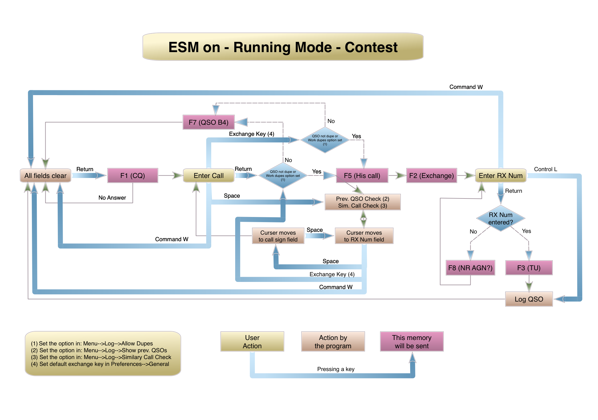

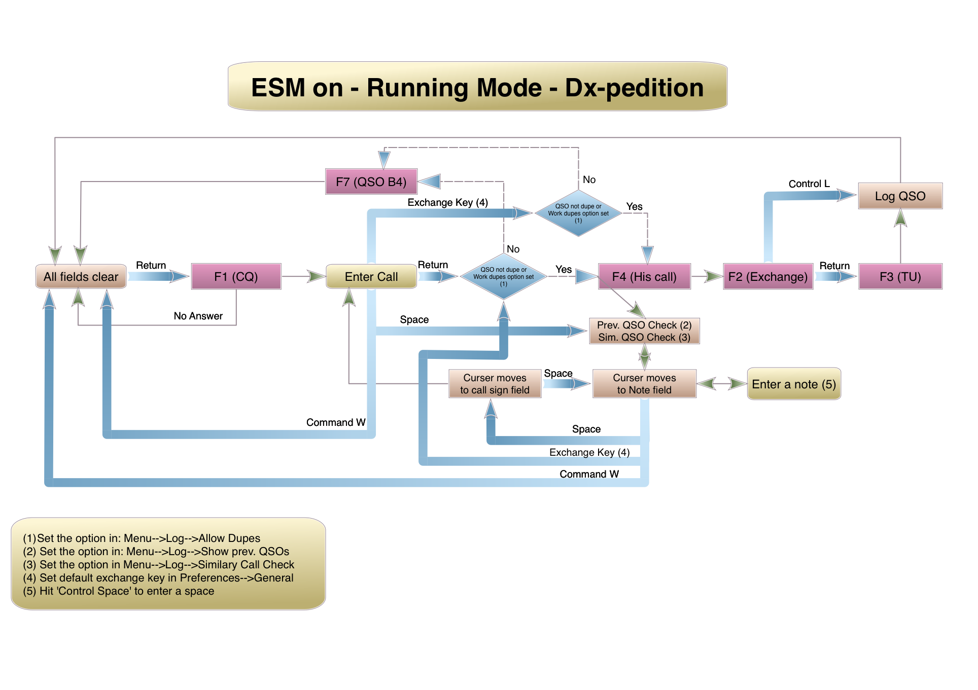

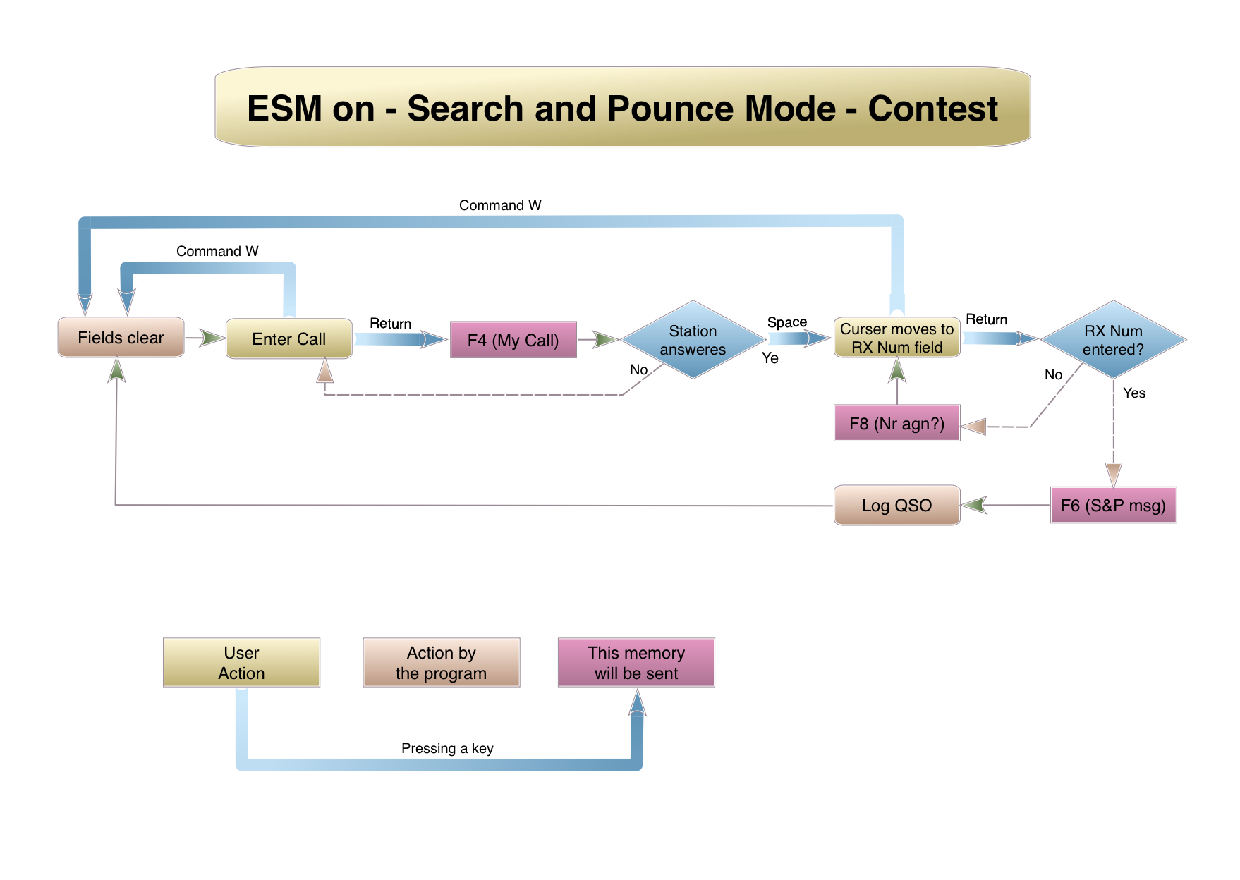

I've tried to create few flowcharts. Maybe it is helpful. I added also the graphics as a pdf file.
How ESM works? (Enter sends messages)
- Attachments
- ESM-Contest-S&P.pdf
- (71.27 KiB) Downloaded 1775 times
ESM-Contest-S&P.pdf- (71.27 KiB) Downloaded 1775 times
- ESM-DXped-Running.pdf
- (104.18 KiB) Downloaded 1691 times
ESM-DXped-Running.pdf- (104.18 KiB) Downloaded 1691 times
- ESM-Contest-Running.pdf
- (121.54 KiB) Downloaded 1713 times
ESM-Contest-Running.pdf- (121.54 KiB) Downloaded 1713 times

Re: How works ESM? (Enter sends messages)
I must have missed this in the instructions.
If I am in S&P mode using ESM everything goes fine unless the other station asks "NR?". By that time ESM has already logged the contact and the number has been incremented.
If I hit F6 again it will send the next number.
Is there a way to send the original number without going to Keyboard mode?
TIA
TIA
As far as I know someone reported this before. It seems to be my fault. Stay tuned ....
