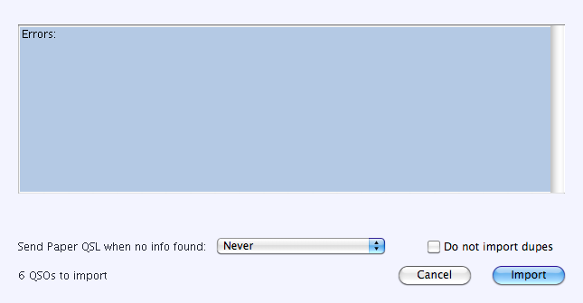

Here is the solution:
During the import routine RUMlog asks you how you want to handle the QSLs --> Select "Never"
When your exporting program uses a <qsl> tag with an undesired information (QSL requested or queued), you can use a simple text editor to remove these tags. (<qsl_rcvd> or <qsl_sent>) Just use the "Find and Replace" command to remove or modify these tags. Nonsense tags will be ignored during the import. ( I could add an 'Override' option, so the qsl tags will be ignored always. Then you don't have to modify your ADIF file.)
When you get paper QSLs use the "QSL in Window" to mark these QSOs: Menu-->QSL-->Paper QSL in
During the next print job, only these received QSLs will be answered and printed.
BTW, for already imported QSOs you can print all QSLs to a file or to "Preview". This will mark all QSOs as 'QSL sent' as well. When you get now the paper QSL use the "QSL in Window" to change the QSL Status back to 'R', just by hitting the 'R' key instead of the Enter Key.
