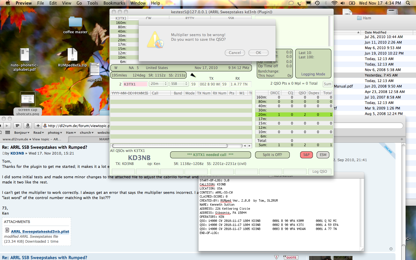

I can't get the multiplier to work correctly. I always get an error that says the multiplier seems incorrect. I am guessing it is in the logic you added to define the "last word" of the control number matching with the list???
Ken

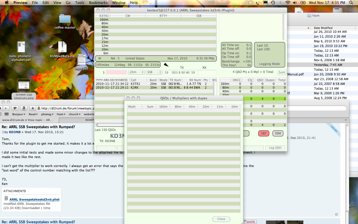

Still not working. See attached screen shots. The multipliers are loading.
Any other ideas??
Ken

Posts: 3120
Re: ARRL SSB Sweepstakes with Rumped?
:cry: :cry: :cry: :cry: :cry: :cry: :cry: :cry: :cry: :cry: :cry: :cry: :cry: :cry:
My Fault !
:x :x :x :x :x :x :x :x :x :x :x :x :x :x
I putted version Beta 36 into the download directory, but Beta 37 is required! Here are the correct files, you have to exchange RUMped.app only:
http://dl2rum.de/rumsoft/RUMpedBeta.zip
BTW, you can switch off the Multi Check under the Multiplier Lists Tab in ContestMaker.
