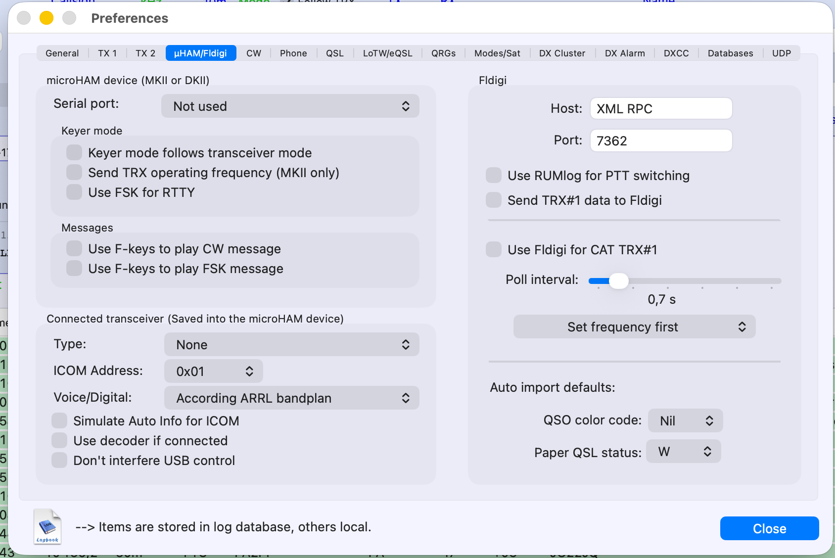

Thank you will investigate but not sure what is the "Enter XML RPC "
OK all good ( had to change port) RL controls FLDIGI etc Thanks

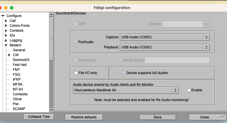

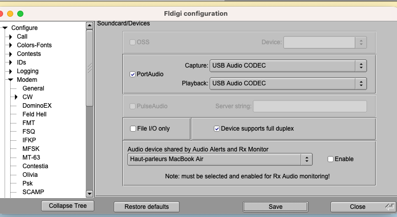

I canot find a FLDIGI forum for Mac but now when trying RTTY CW I have no sound (from TX whne its tansmiting) and nothing is received on the waterfall ?

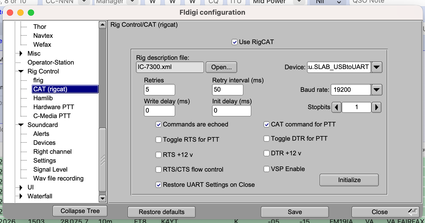

Hello sorry but need more help so far all reading videos etc have made no headway and Fldigi ic 7300 does not work ( aiming for cw and Rtty)
so I have removed FLDIGI from Mac including hidden files etc .

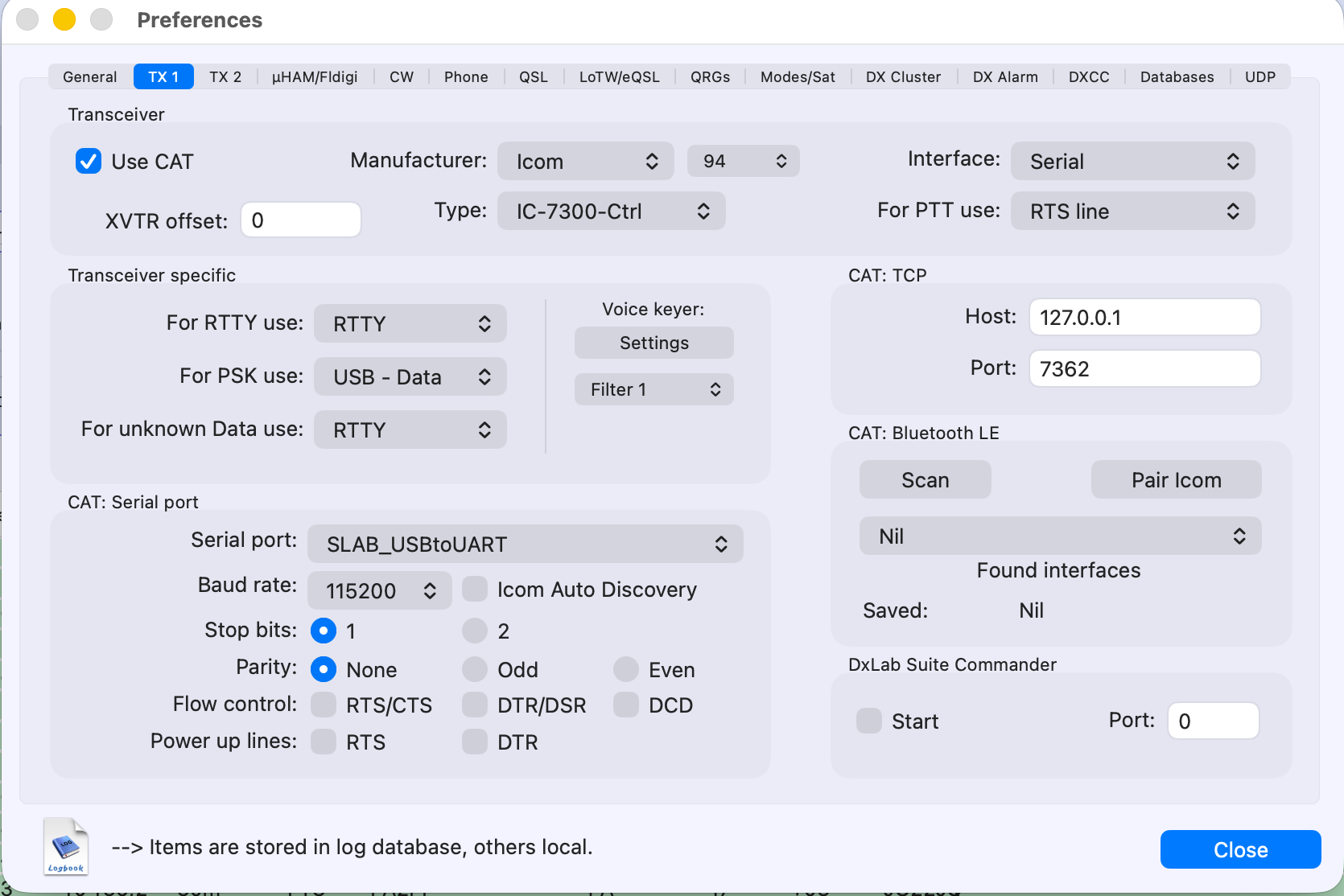

for Rumlog are those 3 screen shots correct ? or do I need to do something else if ok I will proceed with FLDIGI controls
thank you

In Fldigi --> Host you have to enter the tcp/ip address from the machine where Fldigi is running.

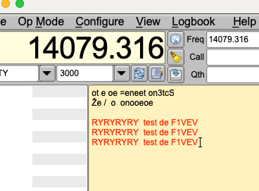

Thank you Tom I now have RL controlling FLDIGI from TX can chose mode QRG etc and FLDIGI follows
RTTY appears and tested OK great but still missing something on CW ? for CW do not wish to use the winkeyer but the rig ? some set up required in FLDIGi

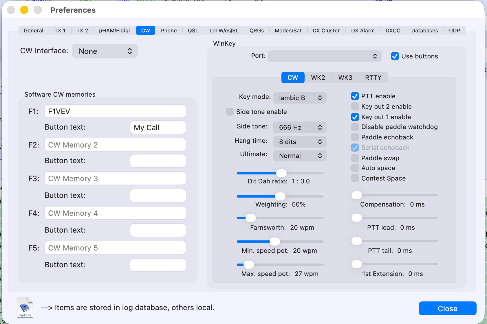

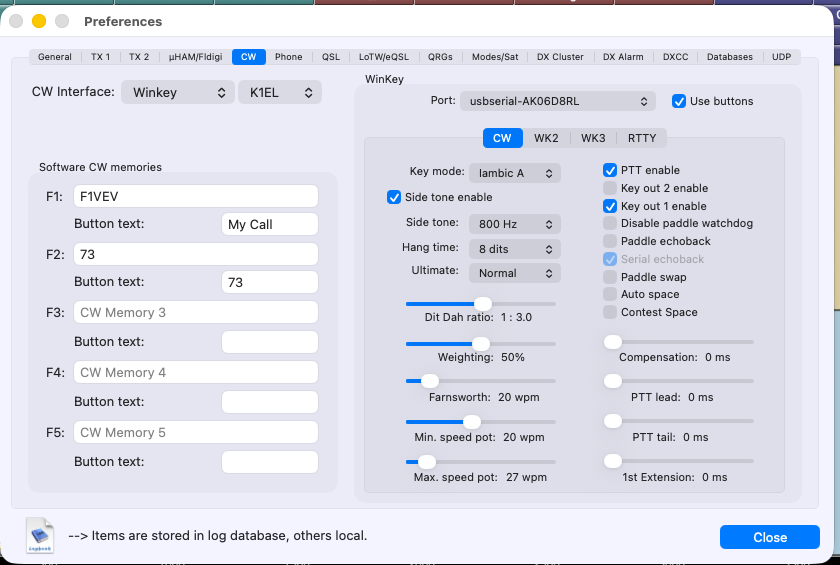

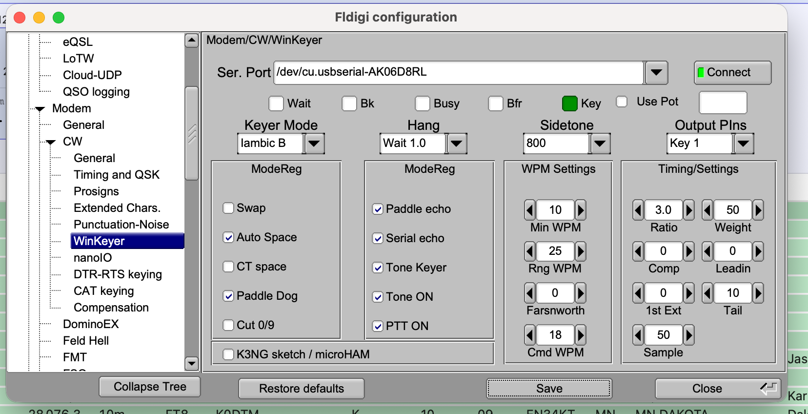

no success with winkeyer ( I have WK3). sorry
Best 73s Jacques F1VEV
Jacques
Posts: 102
Re: FLDIGI set up
Unread post by Jacques »
FYI. all up and running now now need to see how to log Fldigi to Rumlog NG. 73
