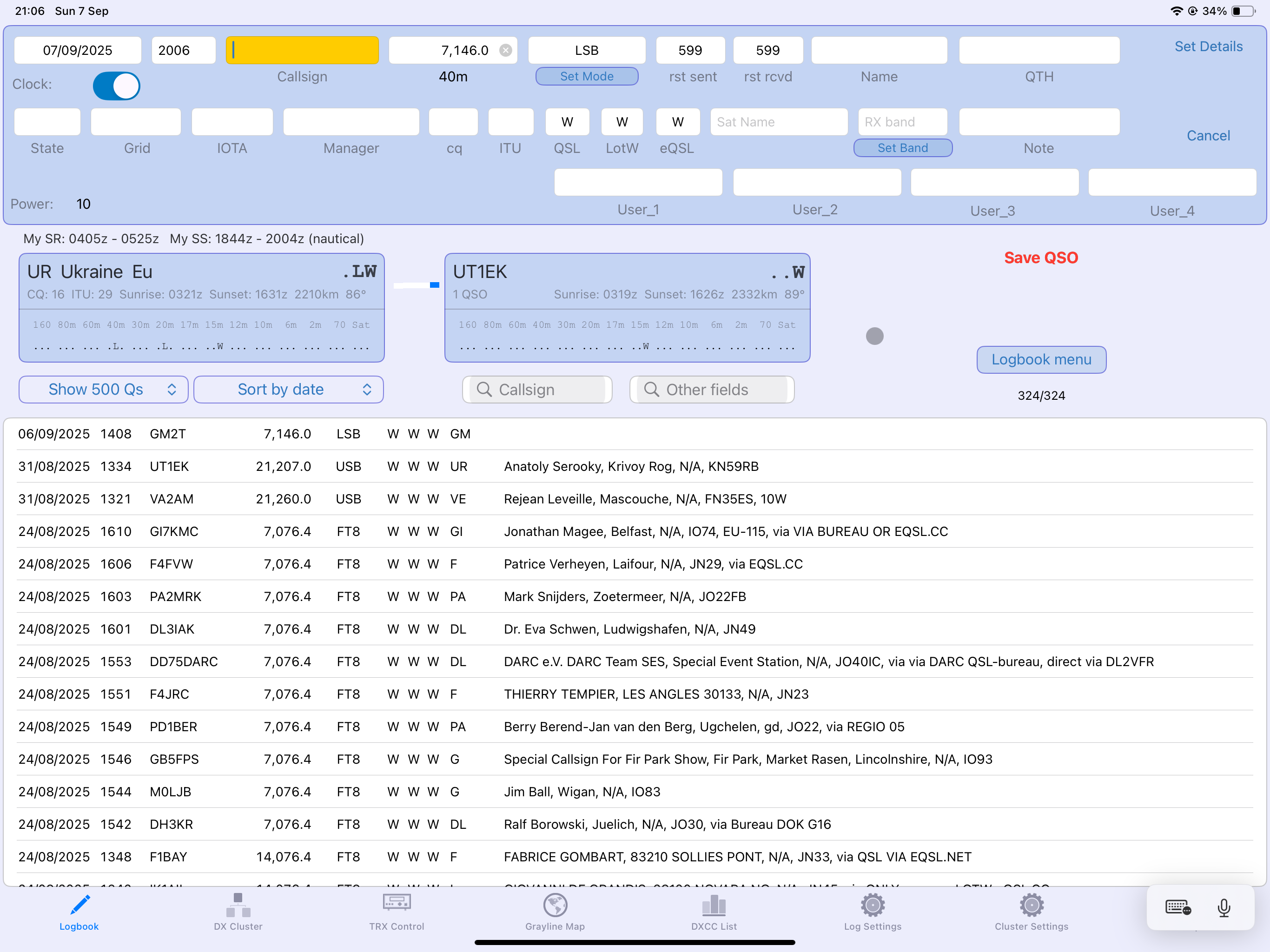

I’m also confused about the section between the Log listing and the QSO entry form. It shows something as follows:
I’m not entirely sure what the middle section is for, in this case it shows a QSO I’ve made and the country it was related to. It appears to be some kind of country filter but I’m not 100% sure. The white line with the blue dot between the country and the QSO seems to rotate if I click on different QSOs from the log below. I’m just a bot perplexed as to what this represents.
It indicates the direction to the station / DXCC entity.
