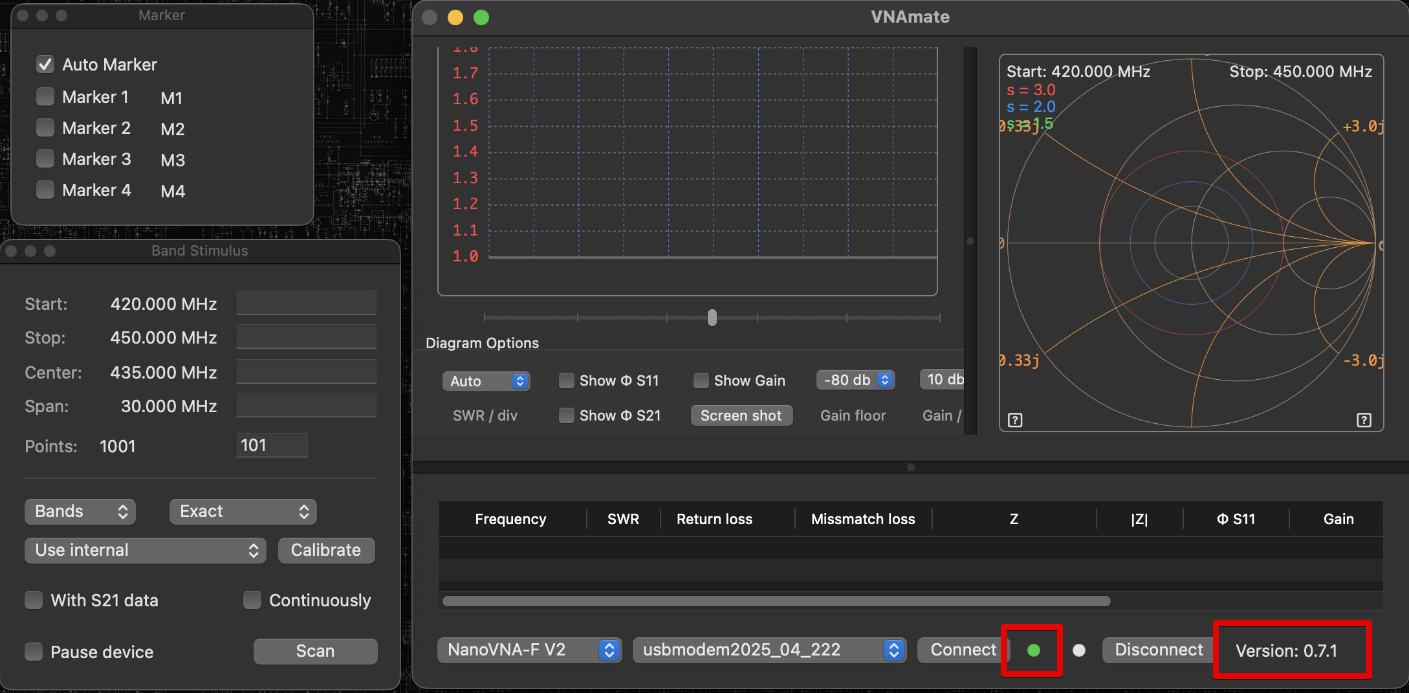

I attempted to use SV6301A which I have, It does shows up and after I connect showing correct firmware number.
I am speculating the issue in your code is related to 1001 points vs 501 points which your current VNA's support.
I can try to force it to 501 and see if that shows up anything. With my default 1001, there is not error or change on the screen except the firmware version.

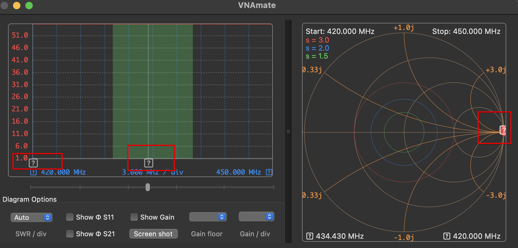

Here is a screenshot for the latest version downloaded today Version 1.2 (6)
The three previous VNA in the list do produce the same output in attached screenshot. The new VNA model when select is prompting me about calibration stating the master calibration is missing. But my SV6301A has been calibrated.
As I mentioned, the firmware version is reported correctly. So something is working. Please note, no antenna is connected, since I just wanted to get a quick screenshots.

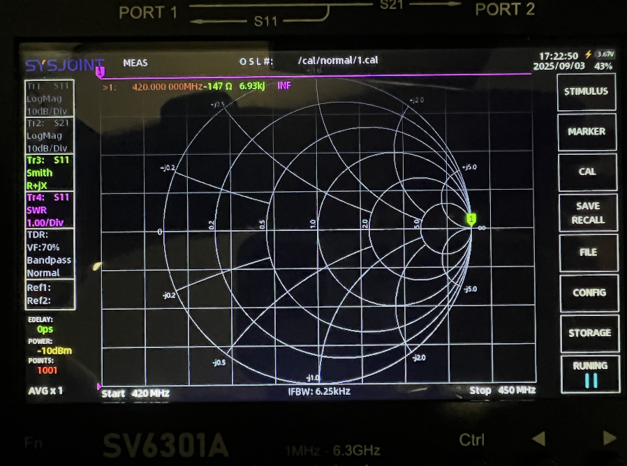

Actual unit connected to MacOS

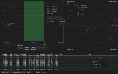

Here it is. Please see attached file.
Using the latest update, it seems some data did come. Anything else?

Which macOS version?
What is the table showing?
It seems you have an Open connected?

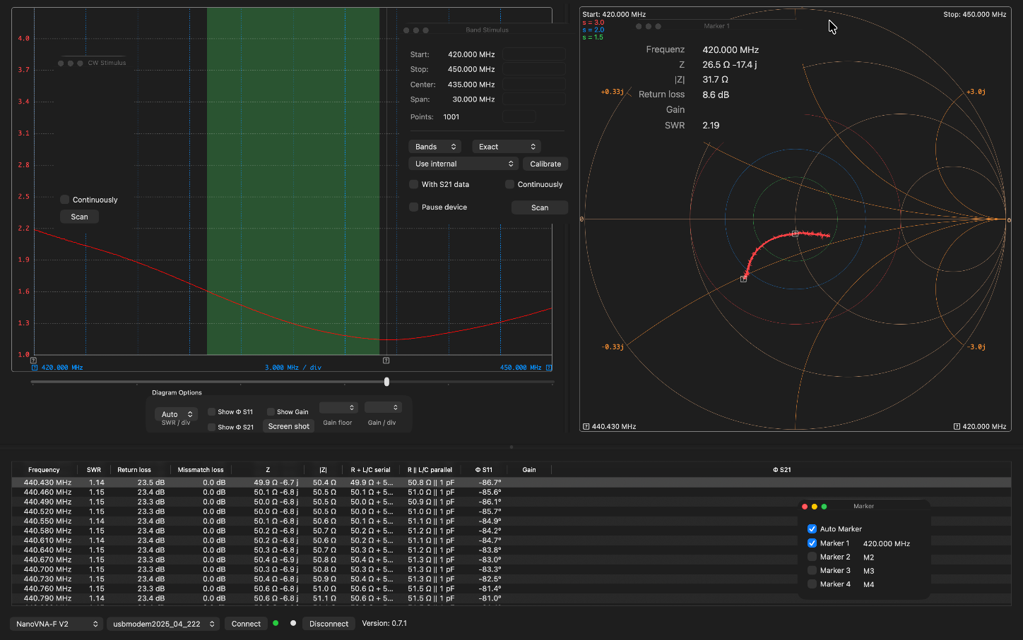

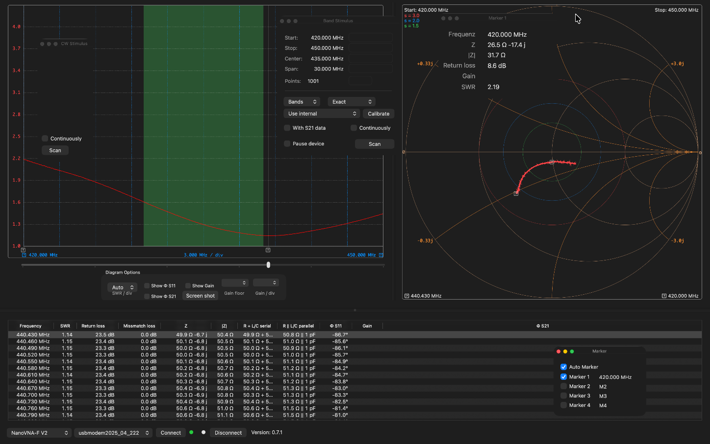

I followed your steps with enabling a Debug and scanning an HT antenna for this test on 70cm band.
I am attaching Debug log here with a screenshot when testing SV6301A VNA and selecting NanoVNA-F v2. Could there be a SV6301A option in the menu?
As far as I can tell the stitch chart and VSWR do look the same in your app and on the device screen.
Are there any other tests you like me to perform and submit Debug log again?
Please outline in detailed steps :)
