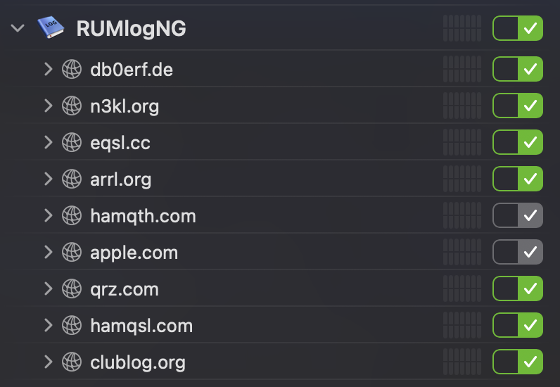

That's really weird. Do you run the version from the app store?
This is what I see after opening the Preferences.

Posts: 3114
Re: Little Snitch alerts regarding RUMlogNG network access
Just it happened to me as well! It indicated webpages I visited for years ago.
I opened the Preferences window few seconds after Little Snitch updated the database.
