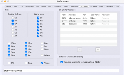

I tried the test with the same results-attached is the crash log. I also removed all the cluster connections and it recreated the one for Kiel so I turned off auto connect and it doesn't crash but if I enable it, it crashes within a minute. I added a cluster back in and after connecting, it crashed with in a minute. I have a screenshot of my cluster settings included as well.
CLUSTER SETTINGS
CLUSTER SETTINGS
