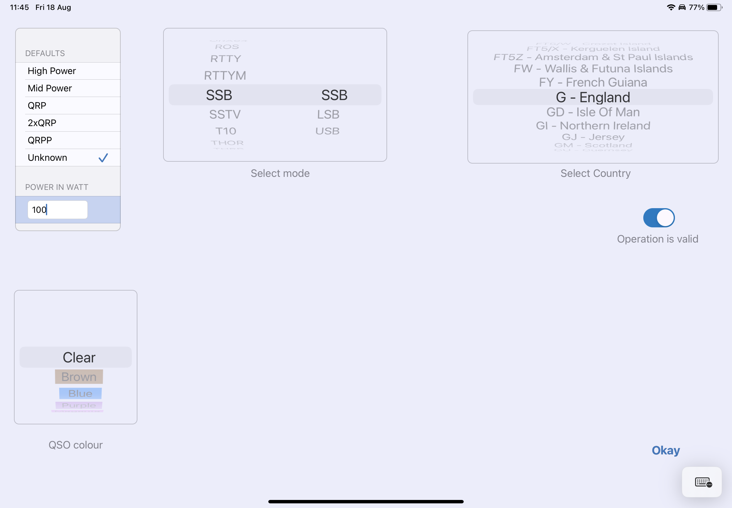

Re: Missing Power Field?
Unread post by G7ORH »
I select ‘Set Details’ and enter power in watts and ensure that the entry has a blue tick, select Okay and nothing happens on the logging screen

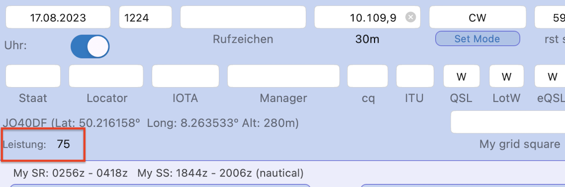

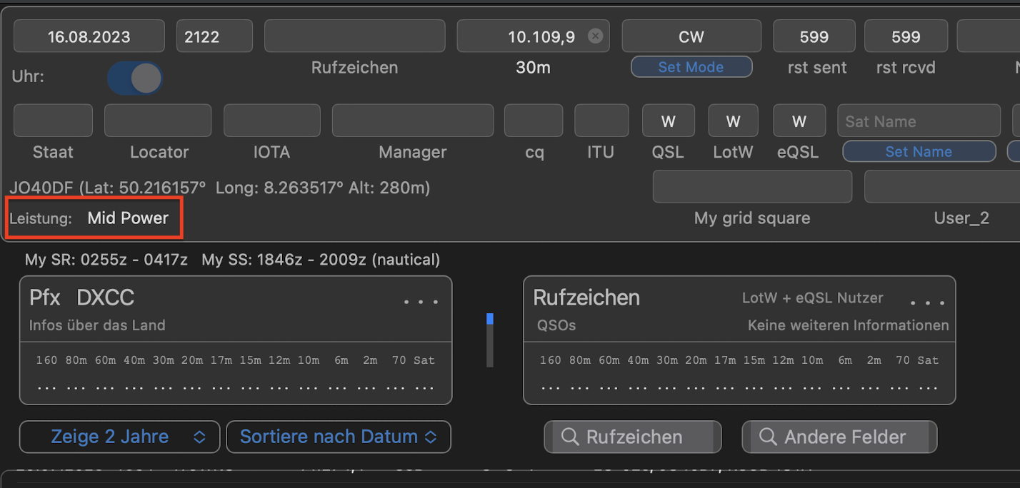

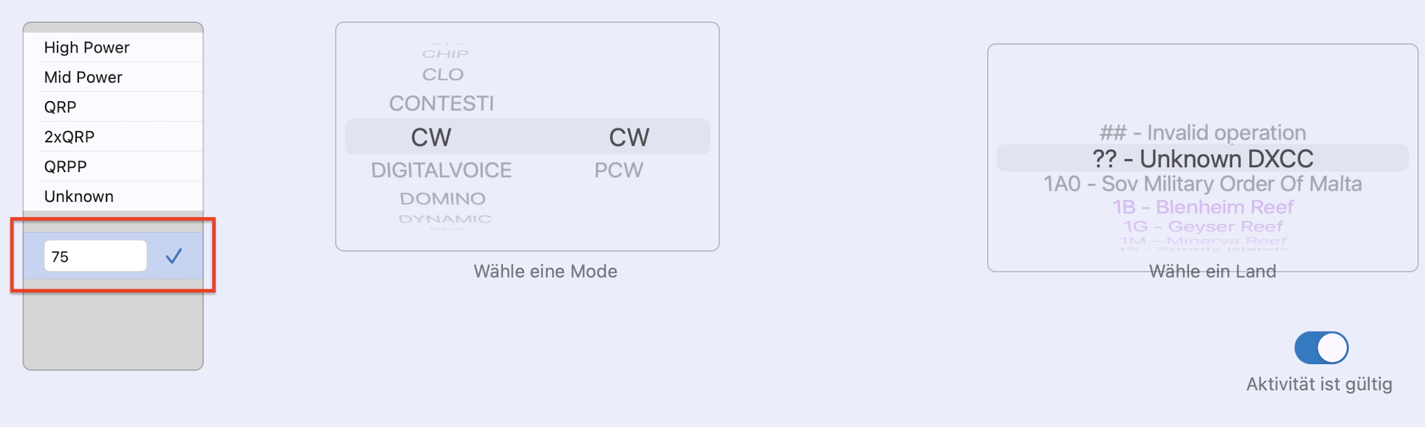

When you have made your selection, you shroud see it:

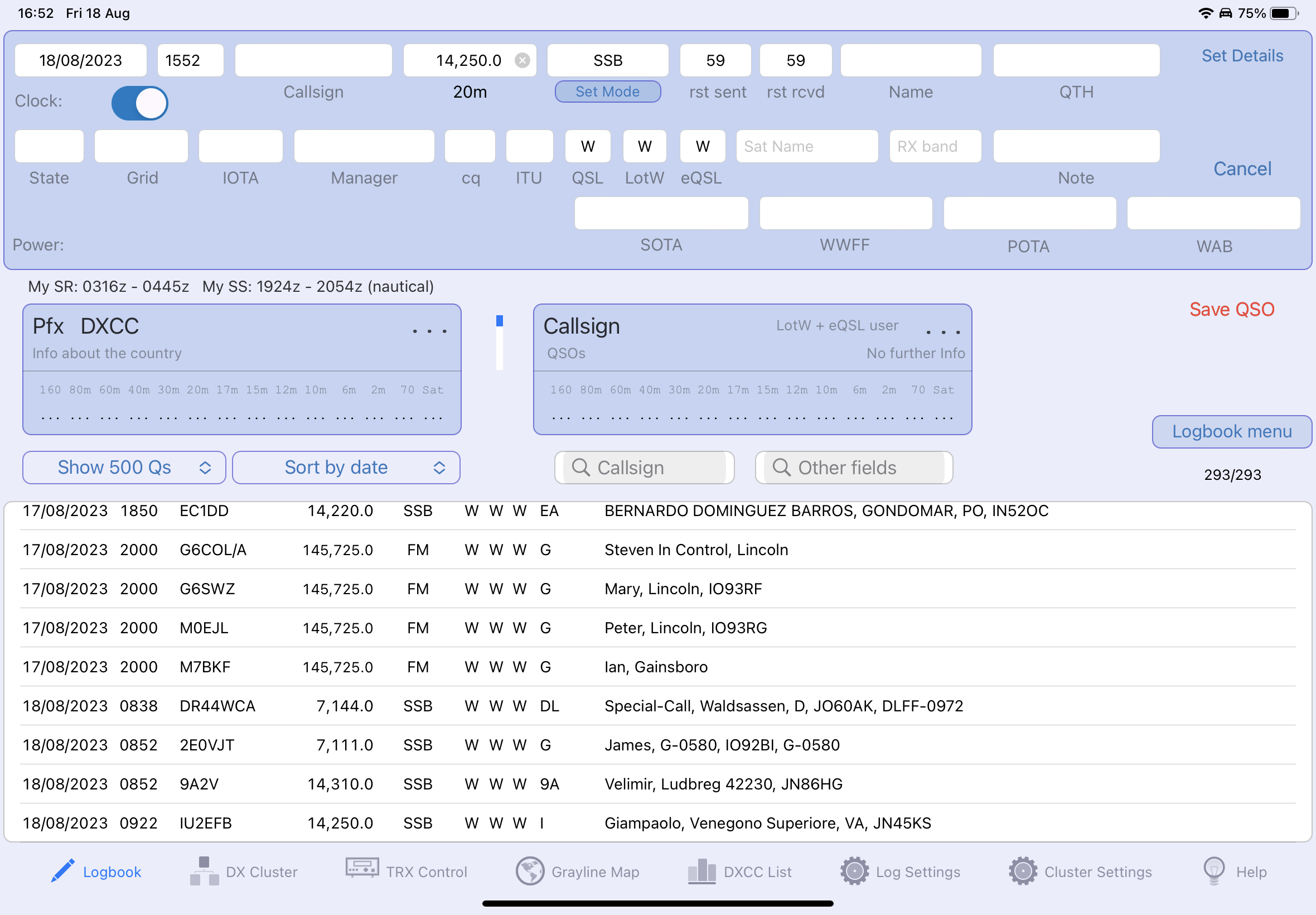

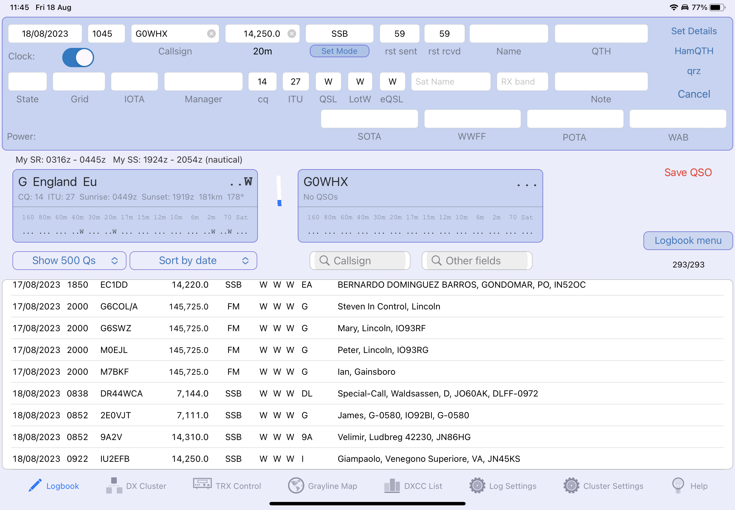

I does not display if I select ‘Power in Watts’, works if ‘High Power’ is selected

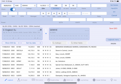

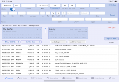

Can you provide screen shots?

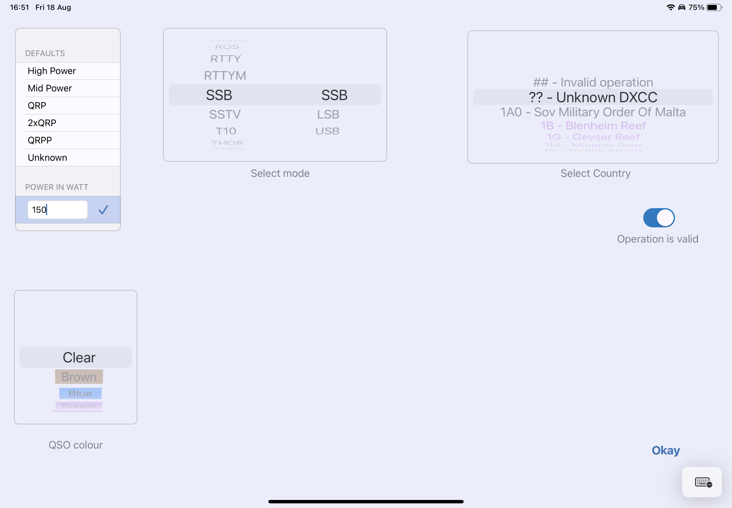

I did move the blue tick down honest!
When you select Unknown, no power information will be saved/shown!
G7ORH
Posts: 16
Joined: Tue 15. Aug 2023, 09:06
Apologies Tom,
I got the photos mixed up, doh,
I select ‘set details’, change to blue tick on power in watts and enter a value. Press okay and back to the logging screen and nothing is displayed.
Okay, I see. It may be a little bit tricky to take over changed data here.
  • Enter the Power in Watt
  • Select another option, i.e. QRP
  • Reselect Power in Watt
