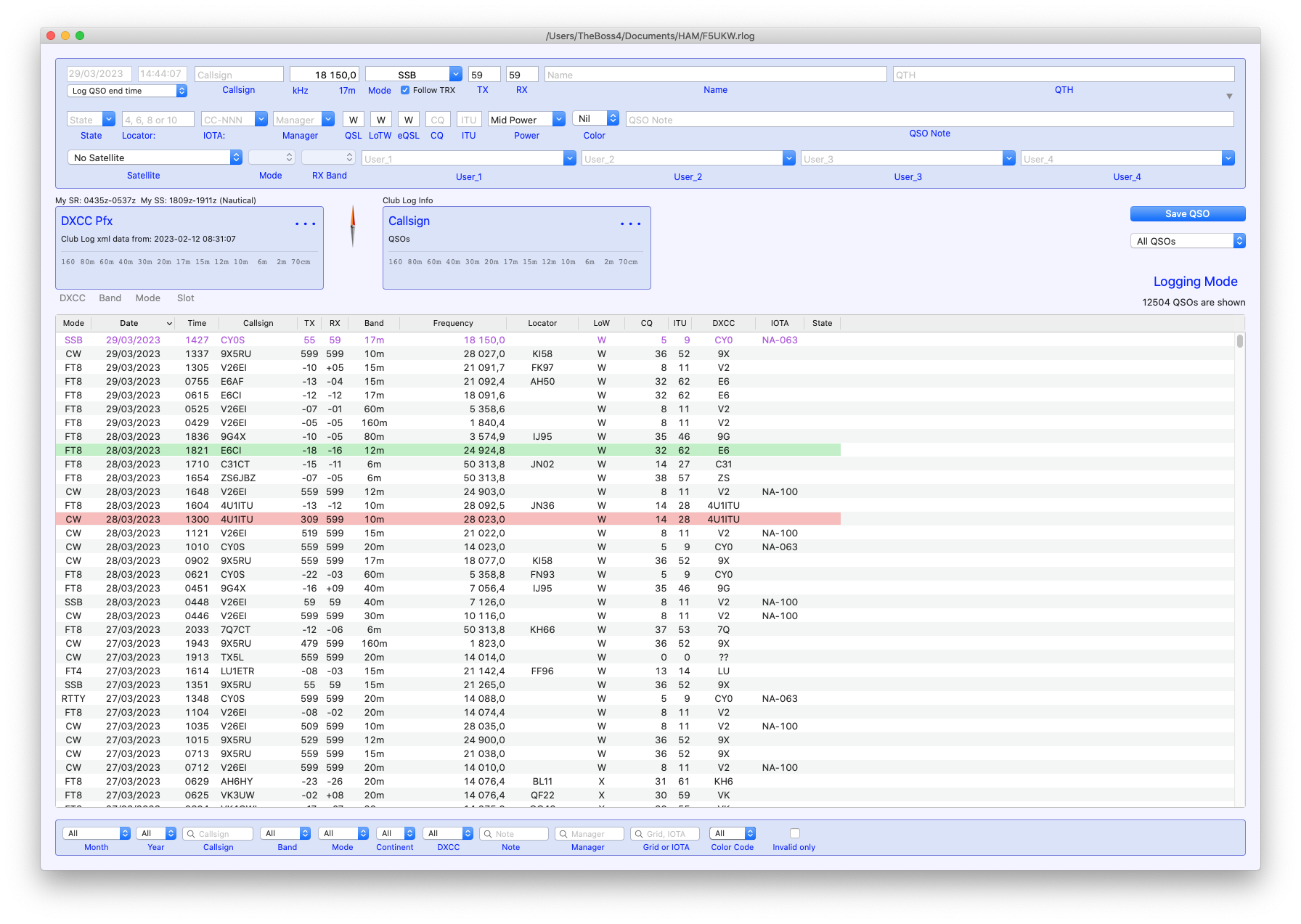

2) Switching back to my regular log (check screenshot), I used feature Import Rumlog logbook file. It worked but it added a colorized entry on my log (look at last CY0S) and seems there is no way to remove it. Can i do something about it or do I have to consider all importation will be like that ?

The magenta text in a QSO line indicates an invalid QSO for the DXCC award. On the Mac select the QSO and use the Logbook menu to recalculate this entry.
