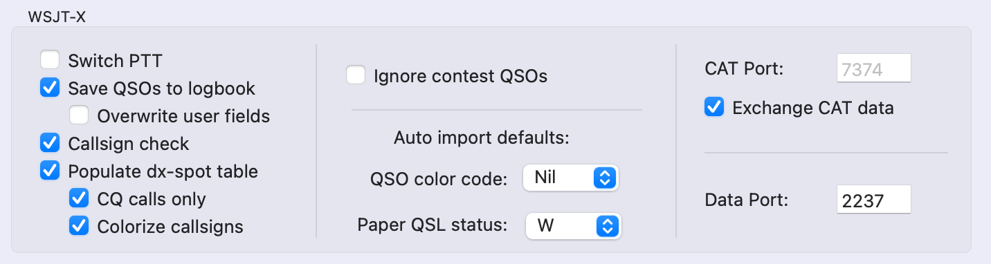

Here are my RumLogNG settings:

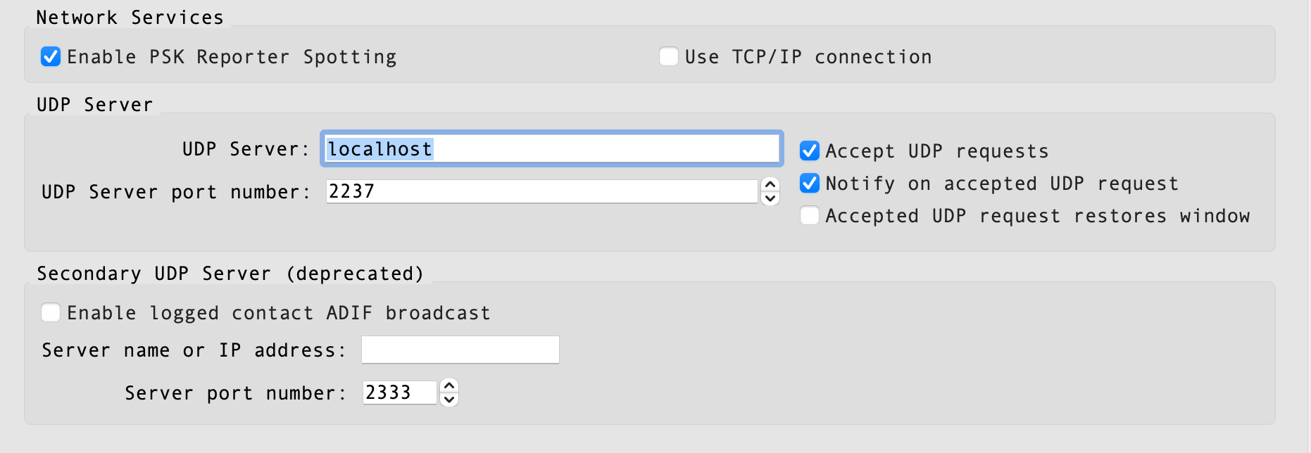

and my WSJT-X settings
Nothing out of the ordinary there. At least I don't think so.
I originally had WSJT-X going to the broadcast address, then GridTracker relaying from 2237 to 2238 and RumLogNG listening on 2238. The reason for this is that I also have HamClock running on a Raspberry Pi which needs to listen for the UDP packets as well. I noticed the odd lookup behavior with this configuration so I figured I'd remove HamClock and GridTracker and try the above settings to eliminate as many variables as possible. The recording above is with only the two programs running (WSJT-X and RumLogNG).
Has anyone seen this? Any thoughts on what settings to change?
