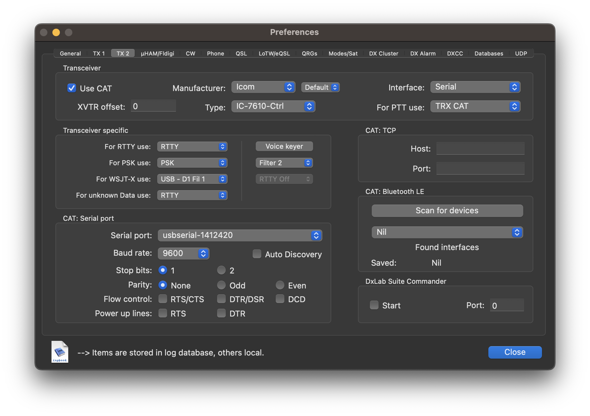

Could someone please share the RUMlogNG>Setttings>TX[1/2] for IC-7610?
1). I can have CAT only at 9600 speed either with SLAB_USBtoUART or with usbserial-1412420. A higher speeds does not get connected
manoschalaris@SV1DAY-MBP-2019 ~ % ls -l /dev/cu*usb* /dev/cu*USB*
crw-rw-rw- 1 root wheel 0x9000005 Dec 27 15:33 /dev/cu.SLAB_USBtoUART
crw-rw-rw- 1 root wheel 0x9000009 Dec 27 15:33 /dev/cu.SLAB_USBtoUART4
crw-rw-rw- 1 root wheel 0x9000007 Dec 27 17:29 /dev/cu.usbserial-1412420
crw-rw-rw- 1 root wheel 0x900000b Dec 27 15:33 /dev/cu.usbserial-1412430
2). The Scope (either Main or Sub) is an empty window
3). Auto discover does not get the Mac connected to the rig. The same happens for "Discover 7610" by Kok, W7AY
Thank you es 73 de SV1DAY

Auto Discovery won't work on some Macs running Monterey or Ventura.
You have to use at least 115200 baud when you want to use the full control window. The best performance you get with a network connection.
Unlink USB from CI-V to allow other speeds.

Thank you dear Tom!
It works like a charm now!
I have just changed the CI-V USB Baud Rate to 115200 and I also set the same speed at the Settings>TX2>CAT:Serial port at Baud rate field.
TU ES 73 DE SV1DAY
