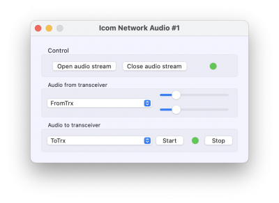

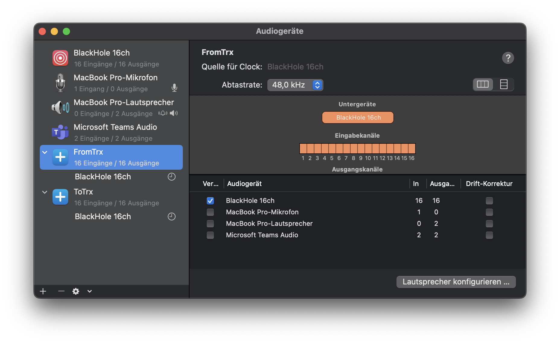

  • Use the Audio-Midi-Setup application to create two new audio devices, one for each direction.

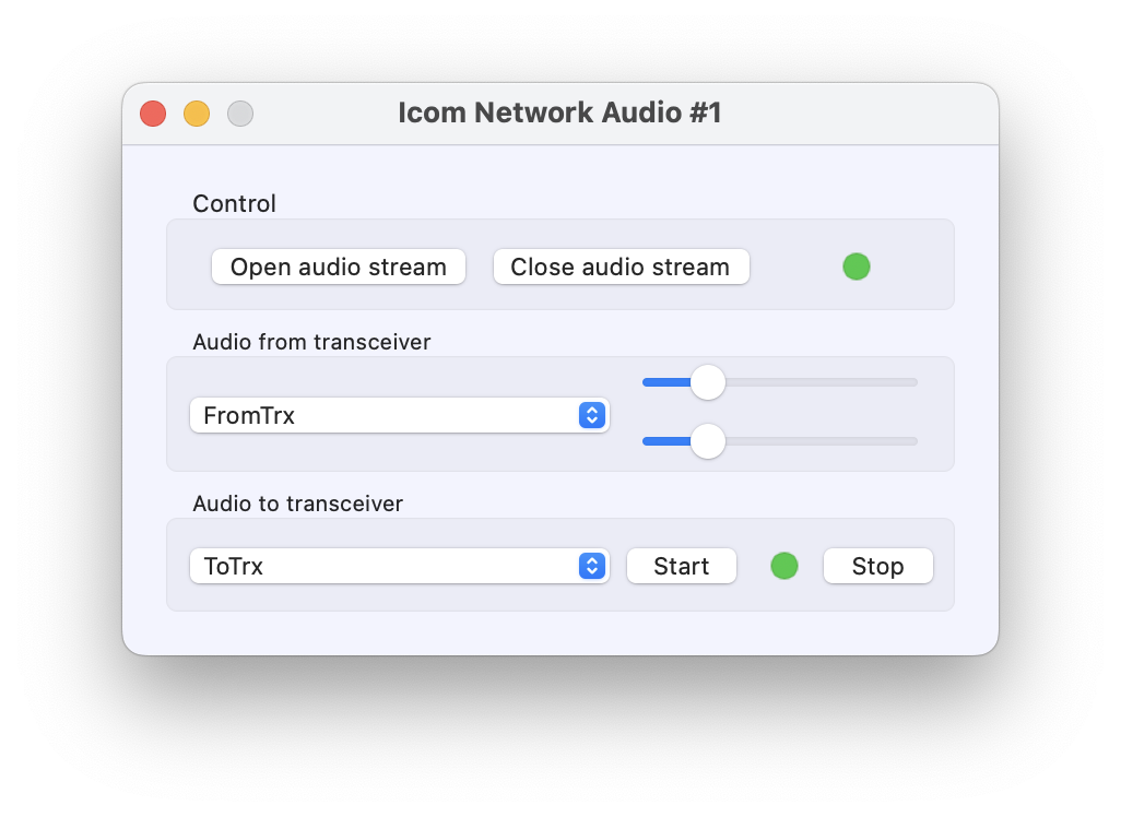

  • When CAT in RL is already running open the Audio window: Menu-->Transceiver-->Audio

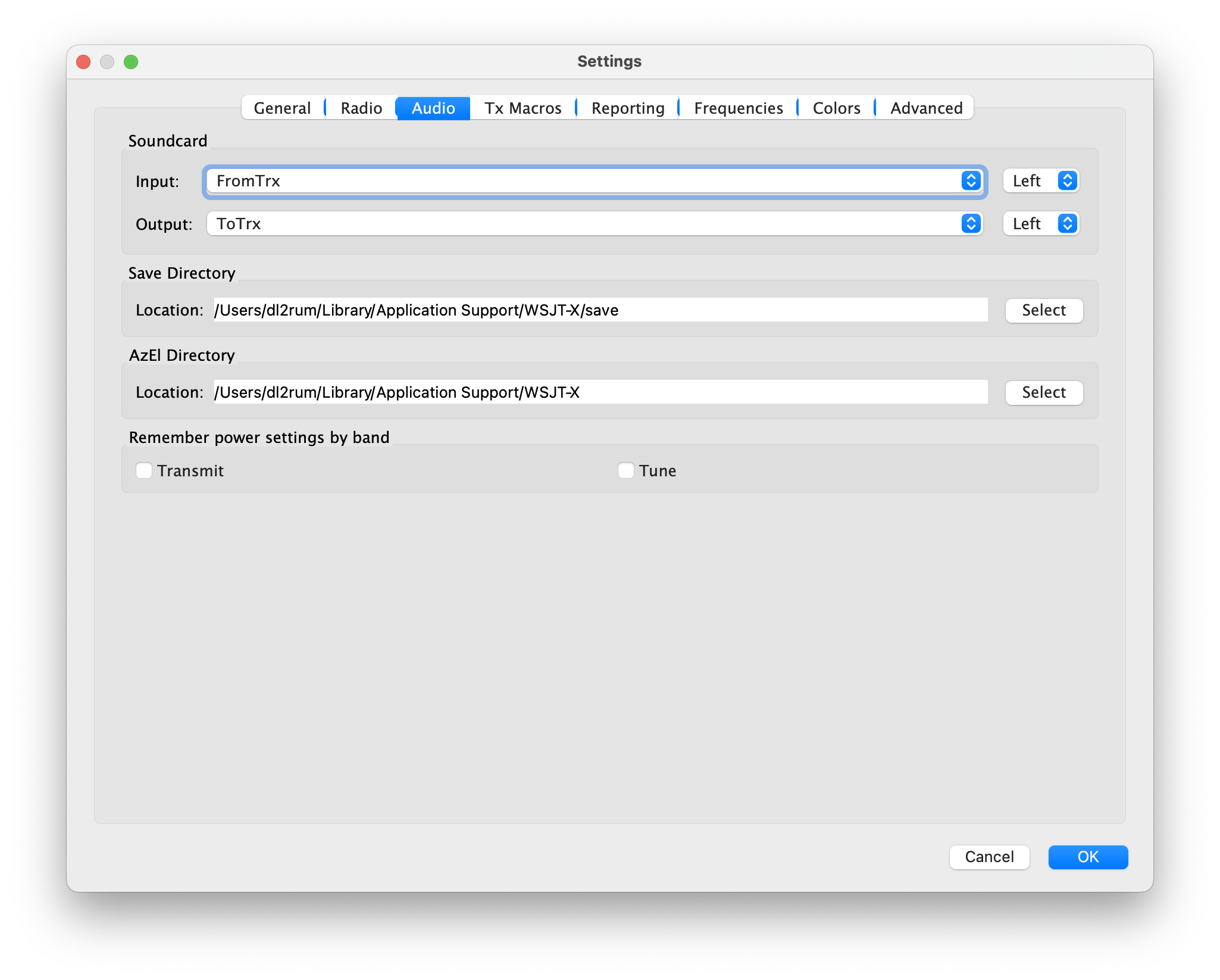

  • Connect the devices accordingly at both endpoints - in RUMlog and in WSJT-X.
  • In RL you have to start the TX audio stream manually. It's off as default to reduce the network traffic.
  • Enjoy
It's recommended to use on all devices the same sampling rate. In the RUMlog TRX Preferences you can select 8 or 16 bit audio resolution and you can fine adjust the audio buffers if you experience audio drop outs. 8 bit audio for transmitting is not recommended, you will get a lot of harmonics.
