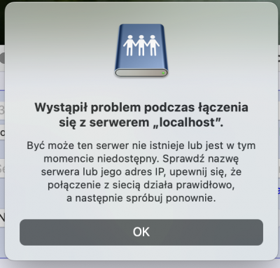

Hi. I'm using recent version of RUMlogNG. During a startup or when any window is opened it spawns "unable co connect to localhost server" message popup. You can see it here:
Someone have any idea what is happening?

What is the full text from the box?

It's in polish - I suppose it comes from system translations, it says:
"Wystąpił problem podczas łączenia się z serwerem „localhost”. Być może ten serwer nie istnieje lub jest w tym momencie niedostępny. Sprawdź nazwę serwera lub jego adres IP, upewnij się, że połączenie z siecią działa prawidłowo, a następnie spróbuj ponownie."
what means
"there was an error during connecting to localhost server. Maybe that server do not exists or is unavailable..."

This is not a RUMlog message. Can you post a screen shot from your Network window?

Yeah seems it's related to network shares.
My RUMLOG.rlog file is placed on Google Drive. I'm using Google drive application - it lets me set some folders, like this with log database, to have local copy on disk drive.
Once I've created new, empty log on local drive, and re-opened log from google drive again problem disappeared.
Issue was confusing, because log was opened as usual, I could write to it and so on.
