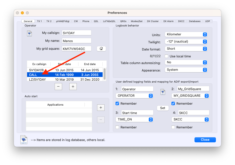

Check your ex-callsigns in the table under the General tab.

WOW! Thank you dear Tom! This was it! I do not know how on earth but there was the callsign CALL in the Ex callsign at the General tab!
