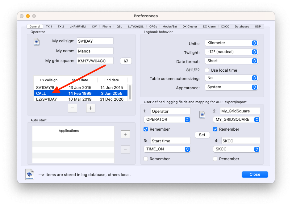

At RUMlog>Settings (previous Preferences)>QSL>Header and footer, one can define a text which may contain the variable <MYCALL>.
At the preview Example box, at the left bottom of the same panel, the variable is successfully replaced to the value stored in Preferences>General>My Callsign. When I tried to print QSL labels though, the Header and footer contain the literal text CALL, instead of the expected value, namely my callsign. Have a look at the attached DF which contains two pages.
Am I missing something?
73 de SV1DAY
Manos

Re: Print QSL labels - <MYCALL> is not replaced - RUMlog 5.10.1
Check your ex-callsigns in the table under the General tab.

WOW! Thank you dear Tom! This was it! I do not know how on earth but there was the callsign CALL in the Ex callsign at the General tab!
Thank you very much!
