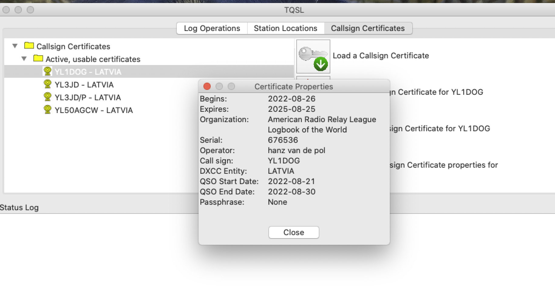

I made a new account on Lotw and have received the certificate. And a new database in rumlog for my ses call YL1DOG.
Installes it inTSQl and i see it between the other certificates.
When adding it into rumlog it is not swhown in the pulldown so i added it manually.
I can upload to Lotw without erros but it never shows up at Lotw.
Please give me hint.
73 hanz YL3JD

RUMlog doesn't show certificates and you can't add certificates. In RL you don't have to deal with certificates. You just have to choose the correct Location. TQSL will use the appropriate certificate for this location.

I checked sending na adif via tsql is fine but doing "Lotw out for qso's" does not end up in Lotw.
I will use Adif via tsql.
