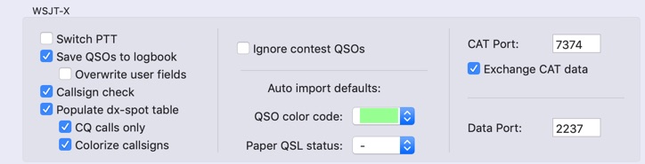

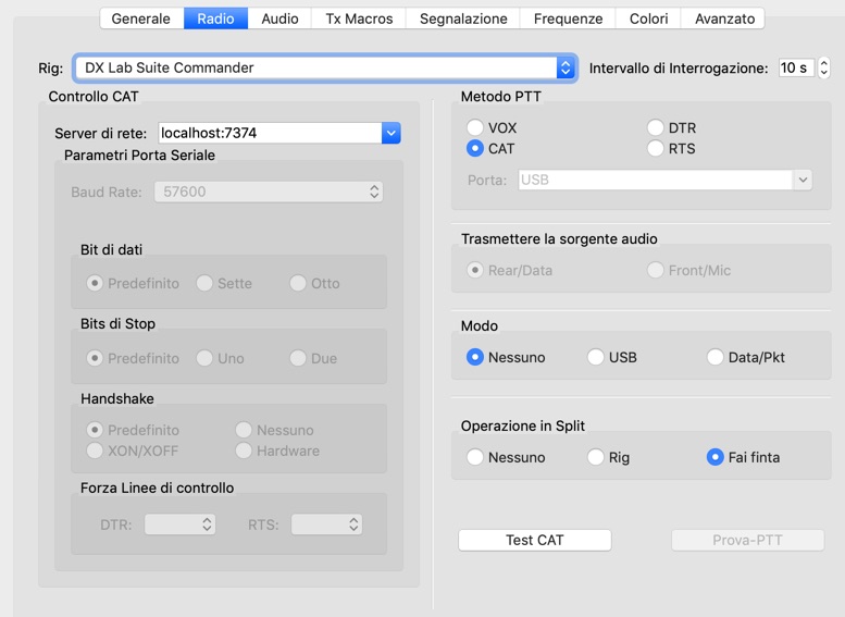

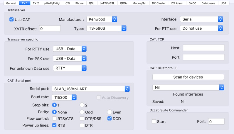

I've enbled the Auto checkbox on the Network Status windows, when RL identifies a new conact, I hear the voice announce "transmitting", the focus goes correctly to WSJT-X but no trasmission start.!
I suspected a wrong cat configuratio, but hitting the "Tune" button on WSJT-X my 590S trasmit correctly.
I do expect WSJT-X to start transmitting auto-magically after I hear the trasmitting audio announcement.... but this does not happens
What's wrong?
Here below my settings for RL and WSJT-X
